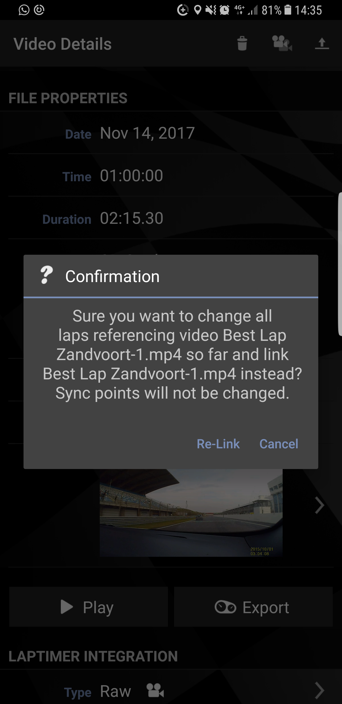

Re: Invalid Master Video Error
I dont think so please see my screen shot, i have selected the option to re-link.
The link did not help me.
I suggest using app screan captures in future, this is much easier to understand than walls of text present in the documentaion.
- Screenshot_20171121-143530.png (473.61 KiB) Viewed 3338 times
Good idea. Please post a sequence of snapshots showing the problem. That's a lot easier. I'd suggest to not work with filenames including spaces and special characters by the way. LapTimer does not use them neither do action cams. It may work, but it is not tested.
