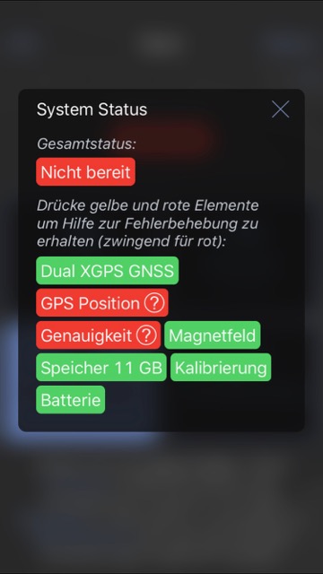

Just received my SkyPro yesterday. It links correct with the Dyno app but the status allways says "not ready". When clicking on the red infos, the GPS position and the Accuracy is highlighted red. But the SkyPro app states 14 sattelites and 3d position fix.

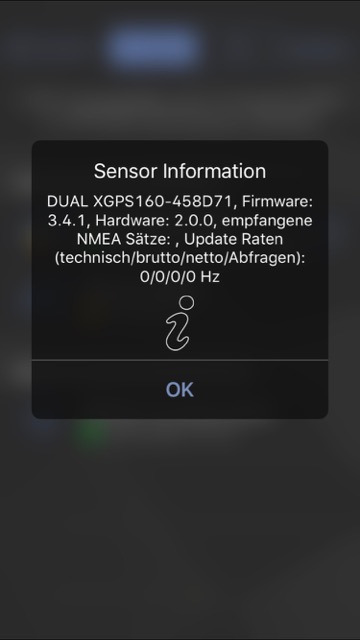

When clicking on Administration/Sensors/Dual XGPS info (the i) and then Info, it states, that there were no received datasets and the update rates are 0 (0/0/0/0 Hz). But when doing the same in GPS Buddy, it says

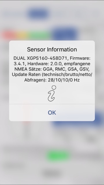

I can also use GPS Buddy and SkyPro app in parrallel and it works. Only in Dyno i have the problems. Attached 3 Screenshots to show the problem. One Screenshot is from GPS Buddy and the other two are from Dyno

I think I know what the problem is. It is the Dual firmware version. While I had updated Buddy and all LapTimer Editions end of November, Dyno did not receive the named update. Support for late Dual firmware has been part of this last maintenance release.
The fix will be added to Dyno v21, it will get available mid of April. In case you own any LapTimer edition, please apply for beta participation (viewtopic.php?f=11&t=4191). As the beta will include an upgrade to GP, it will include Dyno functionality too. The first beta will get available latest in one week.
