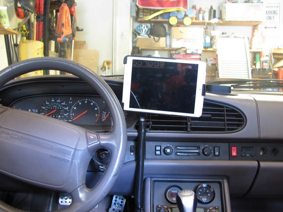

I've been very happy with the mount for my iPad Mini's that I have rigged up rigged up:
ipad mount.JPG (153.35 KiB) Viewed 6800 times
But the owner of the track where I drive doesn't like the fact that it's in my direct field of view, because he's afraid it could be a distraction, and asked me to move it to a different location. I don't find my current location distracting at all, but he's the boss (he's actually a very nice guy), so I have no choice but to move it. Here's the best option I've come up with for having it out of my direct field of view, while satisfying the accelerator's requirements to give static lateral and lineal readings near zero:
Alternative iPad mount.jpg (64.9 KiB) Viewed 6800 times
Sorry about the blurriness of the image; the first one was taken in much better lighting conditions. As you can see, it's in the rightmost corner of the dash. I can tilt it to get the acceleration readings near zero in preset mode, but on page 4 of the document that covers acceleration measurements, it says, " LHT / RHT presets assume you have the phone mounted in the windscreen centered horizontally (i.e. not near the A-pillar) pointing to the driver with an angle of 25 degrees and with a slight tilt of 5 degree." Getting the ipad out of my field of view puts it very near the A-pillar. Is this OK, as long as the static acceleration values are near zero? If not, do you have any other recommendations? Thanks.

Upon reflection, I suspect the track owner may not like my proposed location, either, because while it's not in my direct field of view, he'll probably say there's too much temptation to turn my head to look at it. So, as an alternative, is there any reason I couldn't attach it the the front of the passenger seat where the holes for the shoulder straps go through? This would actually put it higher than where's it's mounted now, and I checked the static acceleration numbers, and they're very close to zero.

Why not lowering the iPad's position and keep the current mounting otherwise? Directly in from of the fans?

I was going to go through the individual calibration procedure, but went ahead and tried preset mode first, and saw that I could easily get the static acceleration numbers near zero with the ipad against the passenger seat where the shoulder strap holes are located. Do you think there would be further benefit using the individual calibration procedure?
And I agree that lowering the unit where it is currently located could be another option, but I thought it was best to have the unit as high in the car as possible. Is this not correct?
