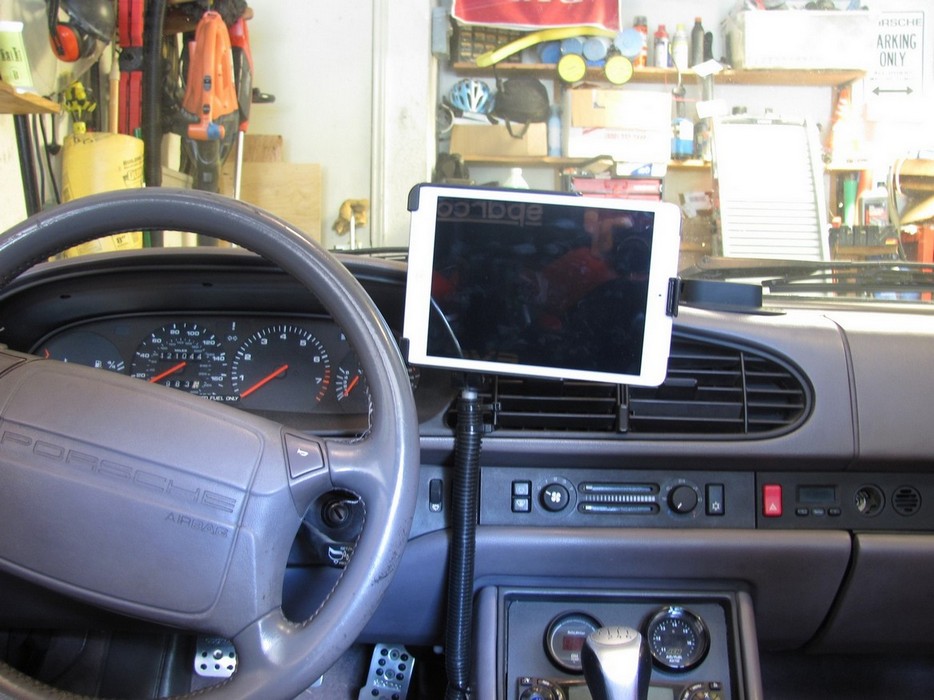

Now you have me wondering if the mount I have in my car is in the optimal position. Is there a way to post a picture in this forum so I can show you how I have the ipad mini, along with the remote GPS, mounted in my car? I'm guessing I have to post them to a site like Photobucket, right?
Re: Lateral acceleration values are way off
You can use the attachment function, it is easier than uploading it to some server and linking it using the [img] tag. Please take care it is a small jpeg file, attachments are limited in size.

OK, here's a picture of my ipad mini's mount. The top of the ipad is about 8 cm above the plane of the top of the dash. Hopefully it's high enough, because being quite a bit larger than a smartphone, I'd prefer not to have such a large object obstructing my field of view. You can see the XGPS160 in its black rubber mount on top of the dash, behind and just to the right of the ipad. When everything is working (the satellites are happy, the Gopro hasn't lost its mind, etc.), the set-up works very well. But if you think the height of the ipad is marginal for robust, reliable performance, I could raise it a little. Thanks.
