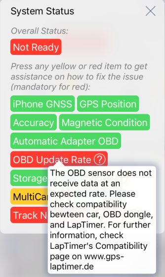

Hi, I'm constantly getting a notice that OBD sensor does not receive data at an expected rate. On the overlaid video RPMs and other data are jumping from 0 to whatever in a moment, but sometimes for several seconds everything works fine. I think (MAYBE) before last update it worked better. at least I dont remember that message popping up. Please help to solve this, not sure if the problem is with Automatic or HLT or maybe my car? I wrote the description of this problem to Automatic and they gave me this link https://community.automatic.com/automat ... -automatic where it says there could be a problem with car's bandtwith.

It looks like Automatic answered your question in their reply. Your car is unable to stream the data fast enough to support the Automatic application and to support HLT. They have recommended using a dedicated ODB dongle to solve the issue.

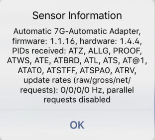

Yes, Automatic's answer is comprehensive and very fair. I haven't been aware the combination of non CAN bus + load from Automatic's app + load from performance apps is actually beyond capabilities so far. I have updated the Compatibility page accordingly. The second snapshot (Sensor Information) means LapTimer has connected to the adapter and sent the initialization sequence (all the AT commands), but hasn't received a reply on any PID (i.e. a reply coming from the bus). As Automatic mostly ignores LapTimer's initialization and implements its own strategy to communicate with the car's bus and 3rd party apps, there is not a lot one can do to fix the issue.
