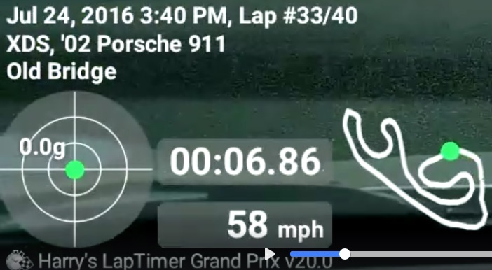

Issue 2 - G-Meter - Not showing anything
This one is weird because I've used this phone with the Petrolhead version before a while back and the G Meter was working so I'm not sure what to make of this. I attached a picture for reference of the exported overlayed video to help elaborate on my issue with this.
After going thru the steps I did for the GoPro (basically Open Harry's > Click Race > Click Timer) I would expect this to work but I was incorrect so can you please tell me what I should be doing to get G-Meter data? My guess is that before I race I should be going into the Acceleration screen and run through a calibration or something. Please let me know.

2) I see you are using Individual Calibration. Not sure why? Using it requires you to run a proper calibration. As long as you make sure the initial step (in the pits standing still) is performed correctly while the phone is mounted already this is fine. But frankly, why adding additional complexity if it is possible to you the automatic Video Calibration Preset. Have a look into illustration 4 in Quick Reference for this. The details are described in Acceleration Handling available from www.gps-laptimer.

I just verified the suggestions you noted for all three of the issues I ran into and all three appear to be working as expected. I didn't get to drive yet to test the g-meter but from moving it around I can see it changing on the video preview screen so my assumption is that it's working as expected.
