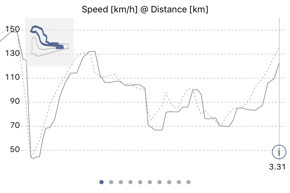

I'm using HLT with internal GPS (1Hz) and GPS speed has nothing to do with real speed. OBD speed seems to be much more accurate.
So it would be great to have all data in vbo-files.
Also I think that column names do not matter at all. VBO-format is pretty simple and I see no problem to change them with text editor if needed. It is much more easier than combining CSV and VBO :)
Re: Enhanced VBO export
GPS and wheel speed are actually better than expected for an internal GPS. GPS will have min/max values clipped in case it is a short peak. The only issue is the sensor delays are not quite in sync (OBD is ahead). You can compensate this (for new recordings) by reducing the OBD delay by e.g. 0.5 seconds. Search for "sensor delay" here on the forum to find more information. Both GPS speed (see column velocity km/h) and wheel speed are included in LapTimer's VBO export already.
