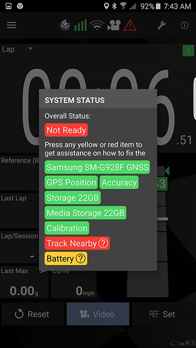

I would like to use the phone in vertical orientation, and have HLT use the external GoPro Hero4 only (that is, turn off internal video recording on the phone). Hitting the video button, I see the message saying "Video operation set to external cam only... Cam(s) connected: GoPro Hero4." However, when I hit the status bar at the top of the screen, I do not see a camera listed at all. The only red warning is for "Track Nearby." (See attached screen of how this appears below.) The question: Is this simply an omission in the user interface? (I would expect to see a green bar for Hero4).

The external cam status is not shown prominently, but it is shown. When External Only Mode is selected and the cam in the status bar is white - it is active. For the GoPro you will see green / blue bubbles regularly on top. They occur every time status is exchanged.
