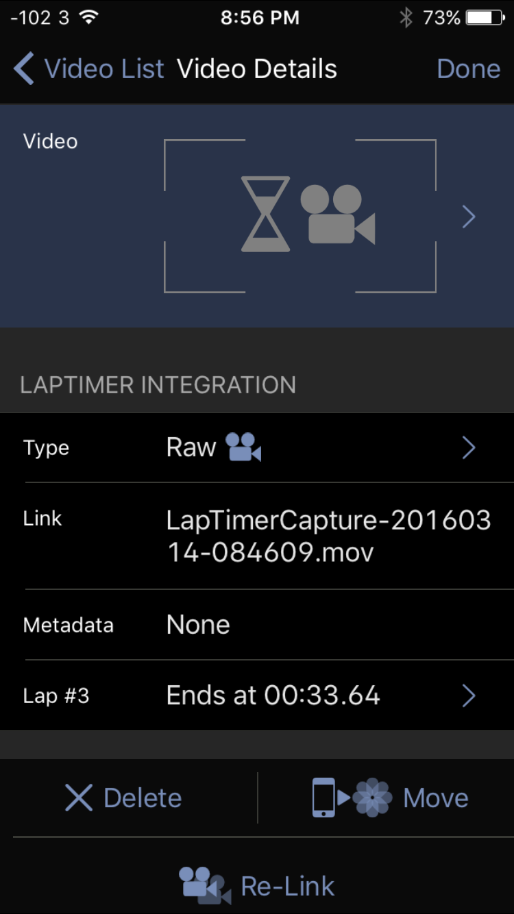

When i try to "Move to Photo", it showed up "Transferring Video to Library" but it seems never completed....

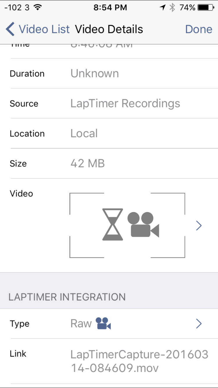

Then i quit the app and reboot the iphone and go into the app again and try to click on the Video, the video is not showing up but the phone screen just held up as below. i can quit the app but the phone becomes not stable again.

Re: App always hangs up and video never worked
Posted: Wed Mar 16, 2016 12:50 am
Hi again,
I just recall some users with hundreds of video clips in there Photo app had issue with video handling in LapTimer. This problem has been worked around for all but some really extreme cases some versions ago...
So please check your Photo app for the number of videos showing up. Try disabling LapTimer's access to the Photo library in iOS's privacy settings. When operating LapTimer like this, video are recorded to LapTimer's data area and overlaid video will stay there too. A full or corrupted Photo library will not disturb any more.
Posted: Wed Mar 16, 2016 1:02 pm
by ct087ct087
Thanks Harry. By disabling LapTimer's access to Photo Library, the video in LapTimer works as expected. That's great!
The remaining issue is i can't "move" those video to Photo Library.....nor copying them out.
