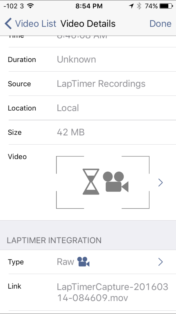

I took a 42MB video.

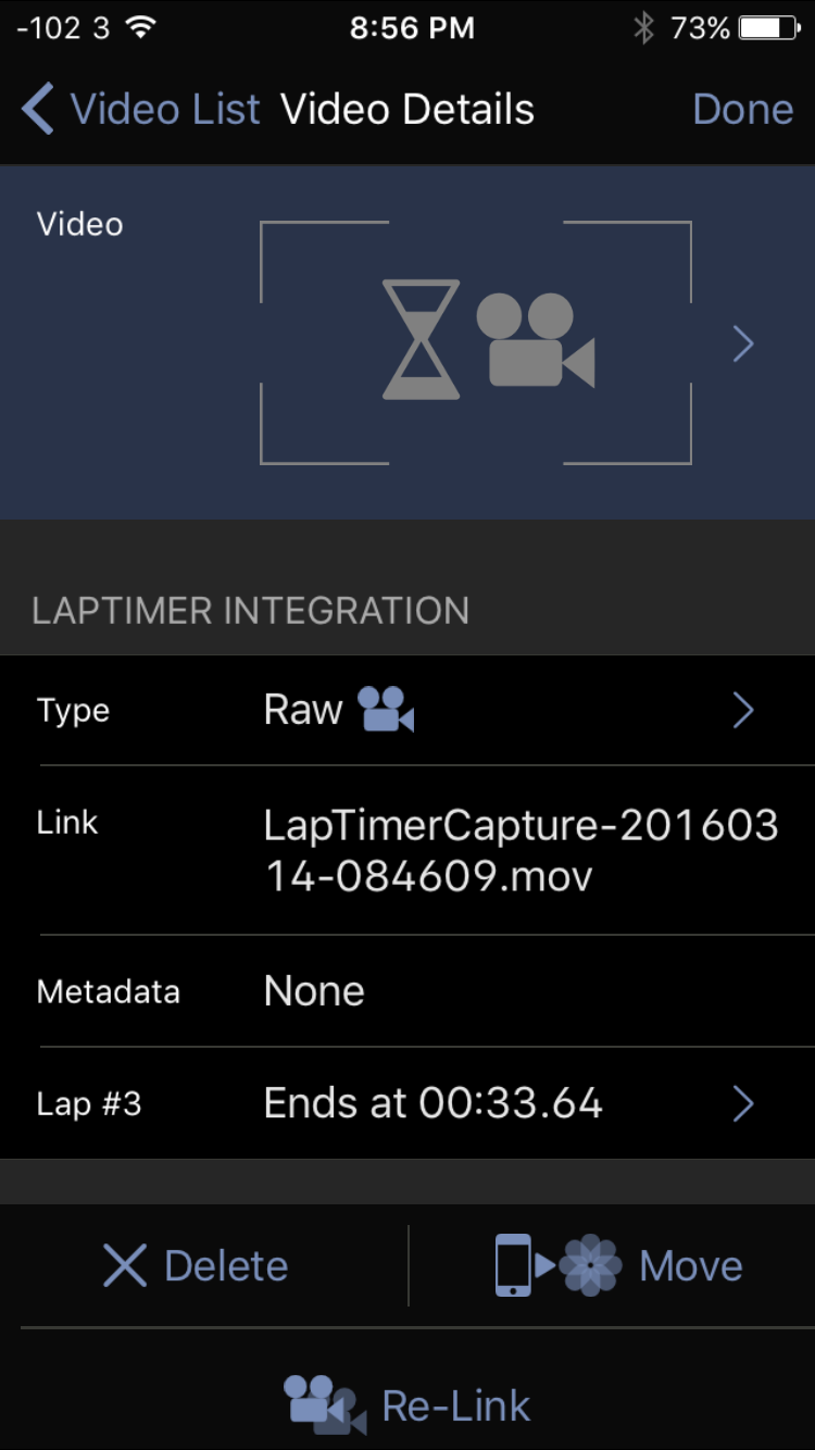

When i try to "Move to Photo", it showed up "Transferring Video to Library" but it seems never completed....
Then i quit the app and reboot the iphone and go into the app again and try to click on the Video, the video is not showing up but the phone screen just held up as below. i can quit the app but the phone becomes not stable again.
