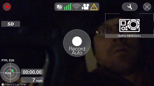

HLT recognizes my GoPro 3+ Silver, but only starts the timer and the iPhone camera (doesn't start the GoPro). Any ideas? By recognize I mean wifi is on, connected to the GoPro, and the top right of the HLT screen shows the GoPro icon.

LapTimer displays the cam when it can locate it. When starting recording, it sends a command - which seems to fail. The usual issue for HERO3/3+ cams is a wrong password. You need to set the password in LapTimer's settings precisely in the way it is set for the WiFi. Take care for upper / lower case. In case you cannot make it working, reset the WiFi connection an create a new WiFi / password. Enter that password in LapTimer now you are sure which one to use.

Thanks Harry. That did the trick. Now I just have to figure out how to use some of these features!
