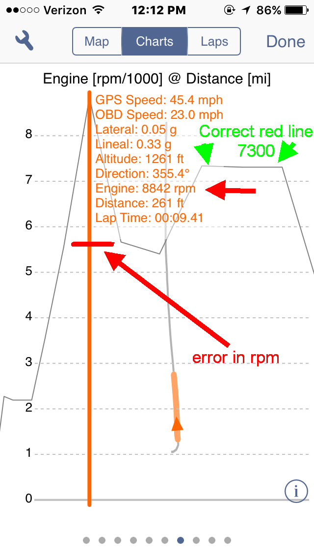

rpm chart.PNG (91.13 KiB) Viewed 3480 times
During a 1st gear run up to red line, I get some incorrect values reported. Attached is a spreadsheet and some images from my iphone5s.

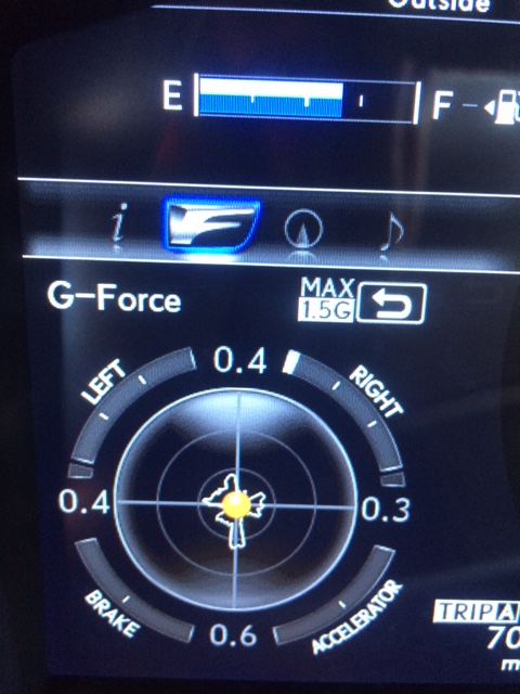

Background: my Lexus RC-F has a G meter and it shows a peak of .6G linear during the run up full throttle.

Laptimer charts shows max .48G Linear, it also shows a incorrect peak 70mph instead of around 60-62mph just after a shift to 2nd. Then laptimers shows a peak RPM of 8842 (worst error) for one sample (jumps from 5542 back to 5665) in the cvs file and this is way before the red line of 7337. My car can to get anywhere near this value of course. I then tried a laptimer recalculate step and the G for linear G went up to .66 which is a little closer to the .6 Lexus reported. I attached the recalculated spreadsheet with come cells colored.
So would adding some splits every few hundred feet in the run up help.
Is this ODB2 device just too slow or error prone?

Try adding a higher update rate GPS to your system. When using the internal GPS it updates at 1Hz. A certain amount of extrapolation is required in that case. You're going to get errors at 1Hz that you won't see at 10Hz.

You may have more problems than that. There's quite a discrepancy between the GPS speed and OBD speed. Are you sure that you're getting good GPS reception on your phone?

As gplracerx wrote, these are artefacts from the low GPS update rate and the comparable low accuracy of internal GPSes. The general rule is: the internal GPS is fine to record lap times, but once you start doing data analysis, you need a 5 or 10 Hz external GPS.
