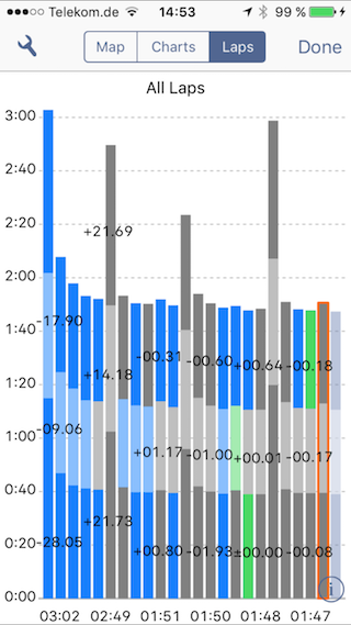

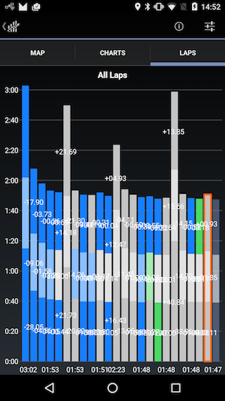

After using both iOS and Android versions of the app I have noticed the theoretical best lap feature is not incorporated in the Android version. This is the feature that uses your best sector times to calculate the best possible lap. This is a very useful analysis tool.
I have included a screenshot of the same lap data on both iOS (white) and Android (black). The Android version highlights the best lap in green where iOS shows the best individual sectors in green. As an example for the last two laps. My 2nd to last lap was my fastest that day however my first sector of my last lap was my fastest of that day. So Android shows the entire 2nd to last lap in green and iOS shows the first sector of my last lap in green.
Another thought for the iOS version, is to put a "#1" above the fastest lap or to outline the entire bar in green? Its easy to find in the lap list with the "#1" but is not easy to locate in the column chart view for iOS.
Also the fastest sector (blue) does not seems to be showing correctly in the Android version. It seems like it may be using the "intermediate" times to highlight in blue. For example, comparing the first two laps, my first two sectors were indeed faster on the 2nd lap however my last sector was 2 secs slower than my first lap. The Android version still shows the 2nd lap, 3rd sector being the fastest at the time of the recording. See the spreadsheet screenshot from exported CSV with some added cells/formulas for details.

Thanks for the analysis, I have probably added some bug during the color redesign... I will check it and come back.

I think I have found the issue, seems the sector number calculation has been screwed up and produced both the coloring issues and the missing virtual laps bar. Here is a sample I used for testing:
Screenshot_20151104-145300 copy.png (128.56 KiB) Viewed 4373 times
I will add this fix to v19.0.25 and try to push it out soon. Once it arrives, please let me know how it works for your data.

Sorry, I did not know you would come out with the update so quickly. The laps are color coded correctly and the theoretical best lap is there; however, I still noticed under the legend it still shows the "Absolutely fastest sector or lap" in red text.
Also, what do you think about somehow denoting the overall fastest lap on that chart (the one marked with #1 on lap list)?

Ok, will change the legend, but that's a minor one. You can see the best lap by turning off "Highlight Sectors" in the chart's options. By default, the chart colors sectors according to fastest so far and fastest. When turing the switch off, LapTimer will color the bars for the full lap time (blue = best lap at this point in time and green = best lap). I had this information in the same chart at some time in the past, but it became too busy.
