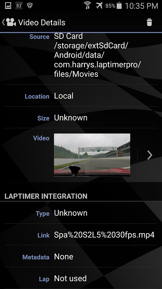

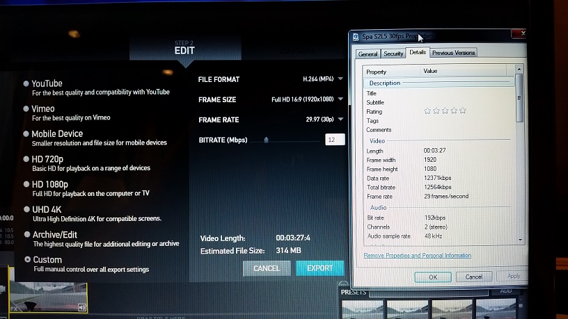

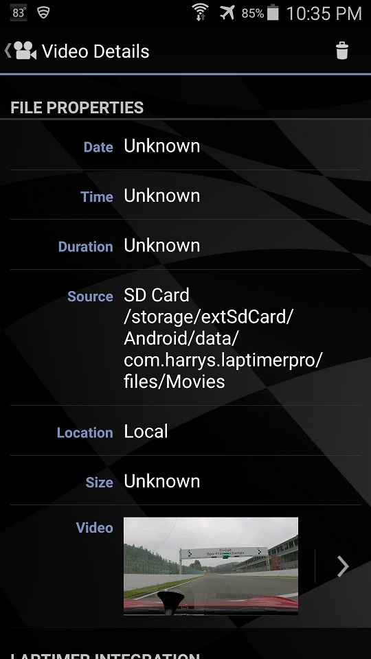

Here are three snapshots that I hope have the info you need. I will also be trying to overlay a gopro video from a Nordschleife lap, and need to know what settings I should use for that video to get a good overlay. Thanks!

Re: Android external video import fail
Please try removing the spaces from the filename.

Wow, I did something very very simple...just changed the file name to one without any spaces and HLT found and processed the video overlay!

Great. I will check where URL / filename conversions need to be changed. As you can see from the snapshot, there is a %20 für each space. This is the way spaces are used in URLs. For filenames, they need to be changed back to spaces.
