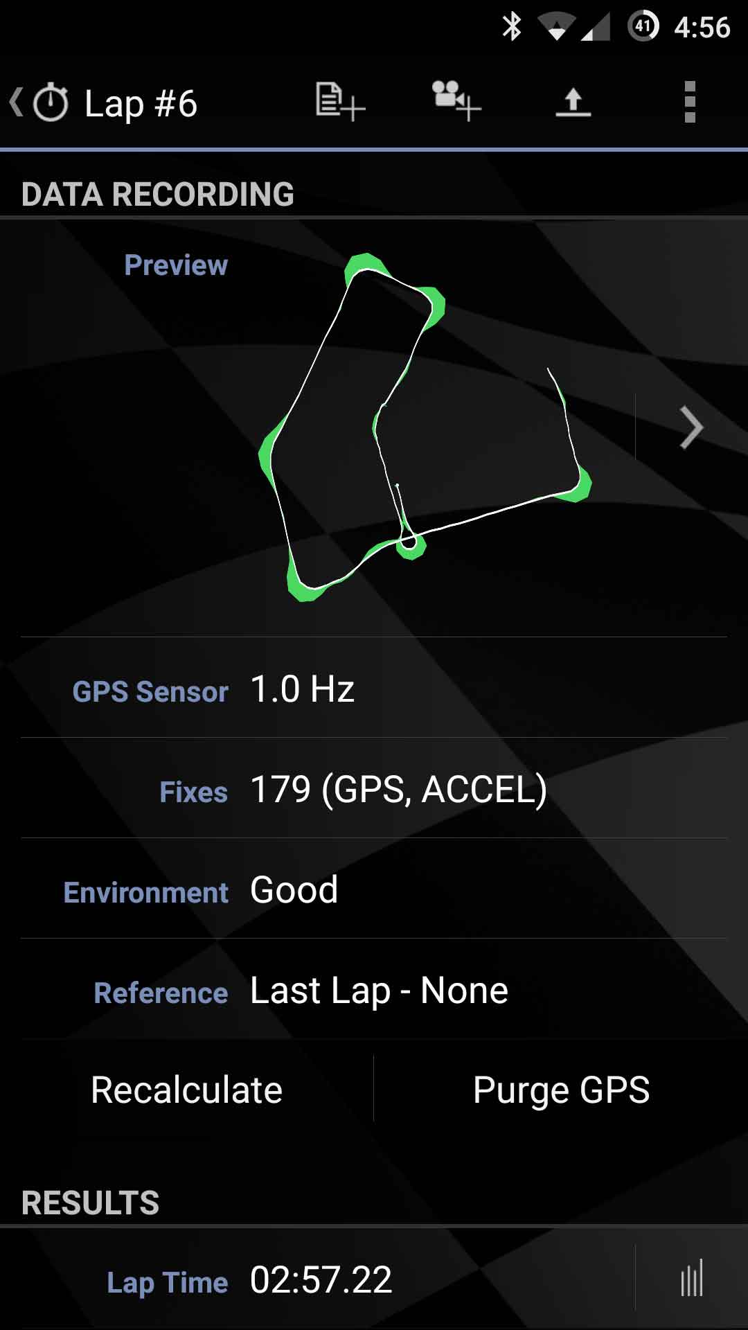

In all my lap details, the GPS sensor shows 1.0 Hz. However, I double check that my GPS is in fact connected and working via the GPS view and it clearly shows 5 Hz. I'm not sure why that is the case. Thanks.

Maybe you lost the connection to your external GPS while recording. Try again. Instead of trusting the Hz calculation in Lap Details, you may just divide the number of fixes by the lap's time in seconds. Calculating is a bit more complicated as it might seem initially as recordings can be compressed....

If I look at the LapTimerGPSRecDB, I'm getting only 1 fix per second.

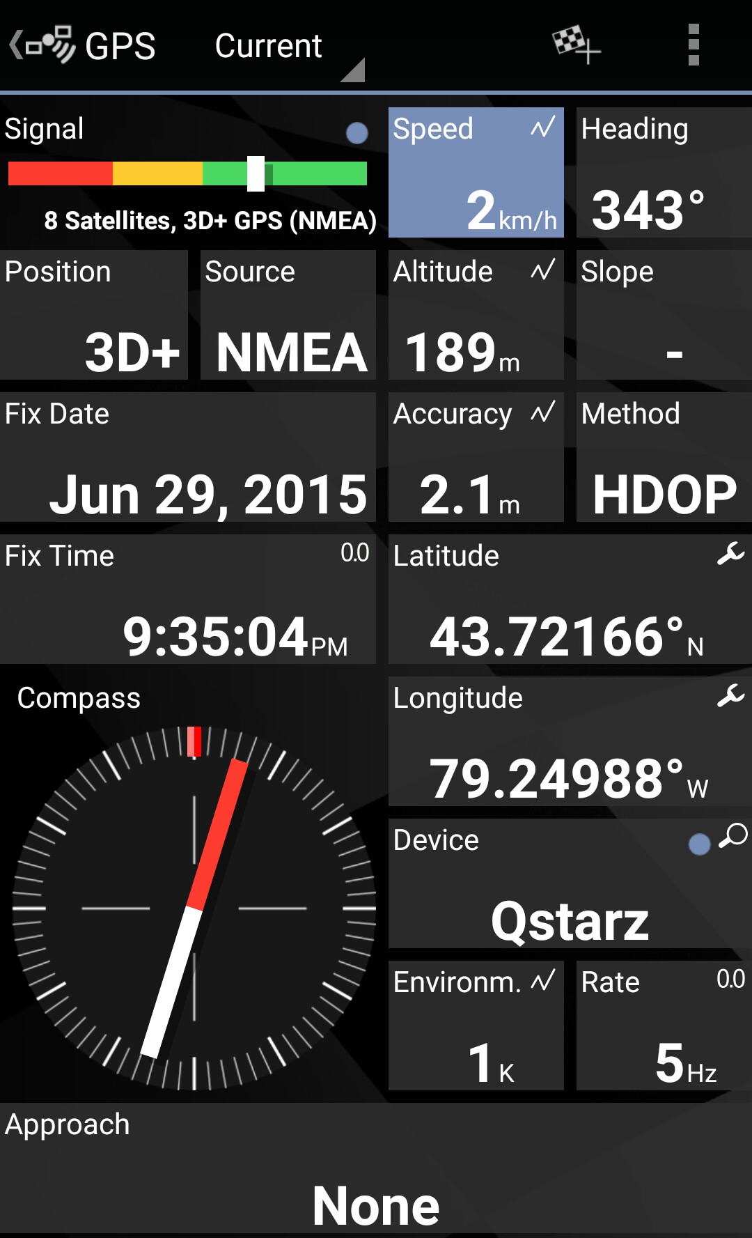

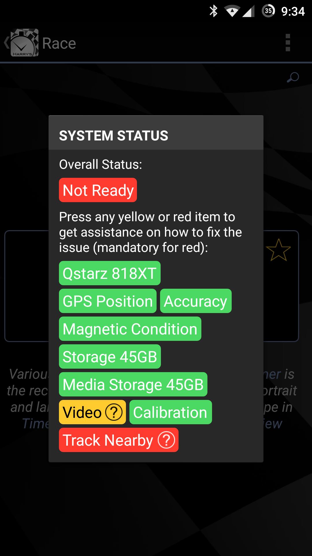

Please send a snapshot of the GPS View with the Qstarz connected. There is no reason it should not go to the database except the system is completely overloaded. You may try your configuration for a genuine Android installation to make sure there is no compatibility issue. Please make sure you have no GPS helper app active in addition.

I have attached the screenshots. If it means anything, if I switch away from the app and back into it, the GPS is disconnected and need to reconnect again. But I obviously don't do that when Ive set it up and riding.

Ok, this looks fine. What is your system configuration? Android make / model and android version? Next step will be to enable manual timing in LapTimer's Settings and create a short test run: with the sensor connected, start recording manually in Timer View. Drive a minute and stop again. Check GPS is still at 5 Hz and check the recording's update rate.

I have tried the manual timer test: Checked GPS view to show QStar at 5hz and then recorded down my street. However, it still shows 1Hz in lap details. You can see that it shows 179 fixes over 3 minutes (1/second).
