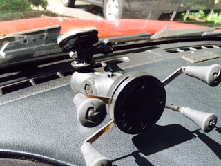

Instead of using the RAM Mount RAM-B-166U Suction Cup that periodically may block the camera lens or falls off the windscreen when the weather is cold, here is an alternative approach:
I now use a GOPRO mount that sticks to the windscreen and is rock solid and very stable. I then attach a Ram GoPro mount with 1" ball and attach it to the gopro mount. Then the rest of the set up is the same as using the RAM-B-166U.
Look at the picture. Plus with the go pro mount I always pass tech.
If you want to remove the gopro mount from the windscreen, then a simple use of a 1" putty knife scraper will do the job. I just leave mind on as it is non intrusive.

...or you get yourself one of these:
http://www.rammount.com/part/RAP-B-378U

Good alternative but I prefer the smaller size of a go pro mount. It helps avoid the situation when the larger diameter suction cup blocks a portion of the video. This virtually solved that issue. Also with go pro mount, it give me an extra pivot point.

More degrees of pivot freedom means higher potential for vibration. That's also why I use a cradle rather than an X-mount. It's too easy to rotate an X-mount and lose accelerometer calibration. The Ram flexible adhesive mount is too flexible, in my opinion. I put one on the car and never use it. I'm going to scrape it off and replace it with a GoPro glue on mount.

It's very true, the goal is least amount of vibration. Since I have the go pro mount, I will try the cradle too.
