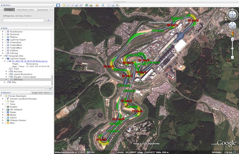

If I double click on the .kml file and select google earth to open it, google earth opens but there is no indication that the file did anything in google earth. Same thing happens if I start google earth, then open file. Don't see anything from the lap timer.
What am I supposed to see when opening the .kml file in google earth?
Charles
Posts: 10666
Re: Can't open exported files on my laptop
Please send your .kml file to LapTimer@gmx.de, I will check. If everything is fine, clicking a .kml file will open it in Google Earth and zoom to the area driven. You should get a picture like the one below. To check if was opened, please have a look into the left sidebar, you should see the LapTimer Export here.
