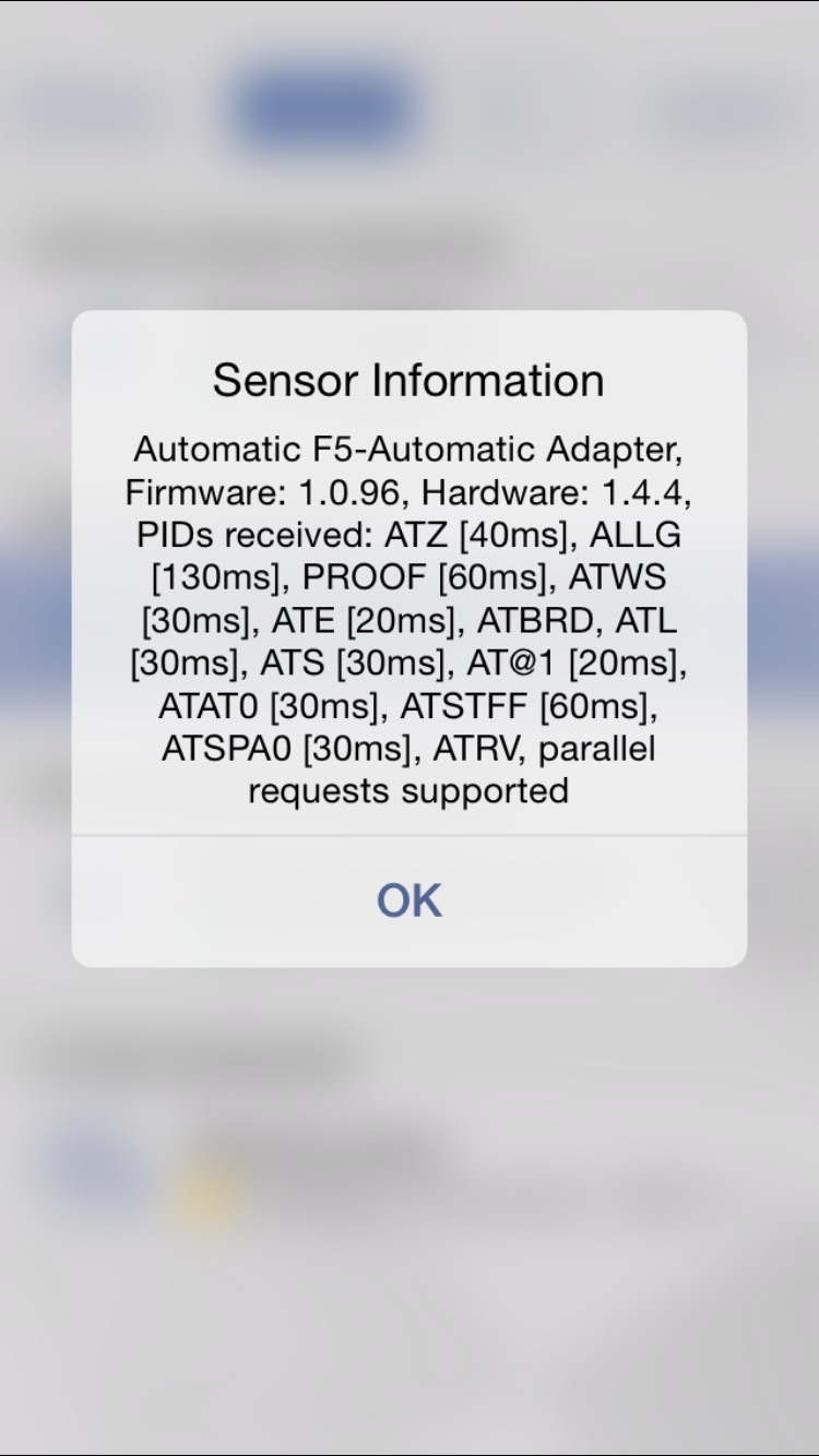

Hi, recently I got the 2nd gen Automatic adapter. I tried to get LapTimer to recognize it, but I couldn't link it up properly as LT reported inconsistencies in the adapter. I tried to follow the debugging instructions (viewtopic.php?f=20&t=1500), but I noticed one thing with the Automatic adapter. It seems to do authorization through their website before other apps can access the adapter. I was able to get LT to connect to the adapter, but when I open up the GPS/OBD Buddy app, it tries to do the same authorization as it did for LT, but then seems to fail to do so. As a result, OBD Buddy can see the Automatic adapter, which is listed as available, but is unable to connect to it.

Please make sure you have the latest Automatic firmware installed. 1.0.96 is probably outdated?
I have no experience if the Automatic adapter behaves well when connecting to two 3rd party apps at a time. Both LapTimer and Buddy close external connections when sent to background, other apps may not. The only app allowed to access the Automatic in parallel is the Automatic app itself.
You are right that access by a third party app needs to be authorized when used the first time. Once authorized, the LapTimer memorized the credentials for the next connection and will not raise the authorization dialog again.
In case LapTimer shows AT commands only in Sensor Information, this is a strong indicator authorization didn't work. So once you have updated the firmware, restart LapTimer and try again.

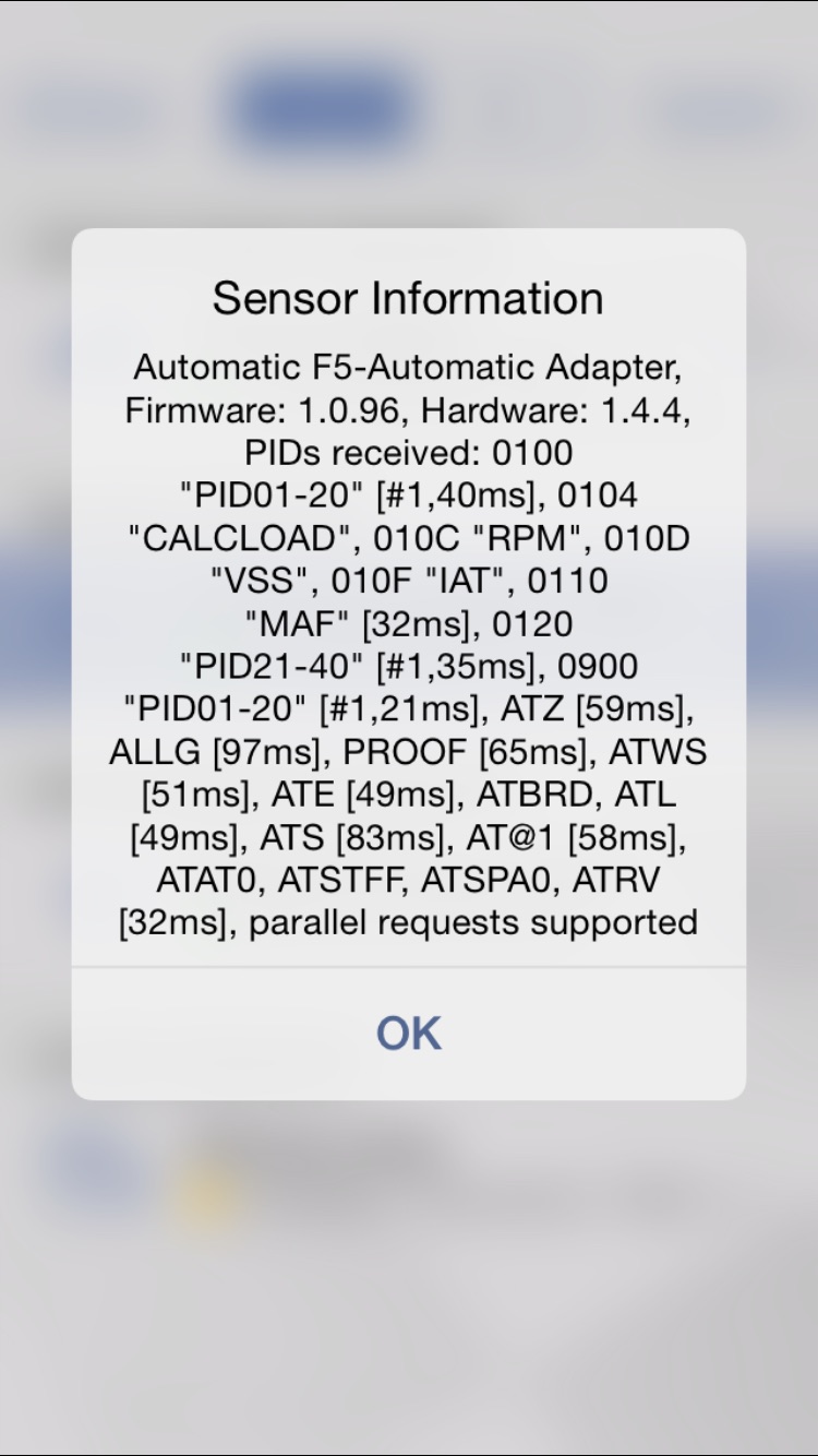

OK, so I think I got it connected finally, and with auto exclude PIDs turned on here's what I get:
sensor information screen
Since I'm unable to use OBD Buddy app due to app authorization issue, what would you suggest next steps be? Do I just go through each of the returned PIDs and try adding them to the exclude list? Is the format just one long string, e.g., 01000104010C ?

Played with it some more tonight, I notice PID01-20 is showing up twice in the list, so I excluded 0100 and boom, suddenly it connected! In the sensor list, I actually got a frequency reading:
Automatic @ 70Hz
However, I was missing RPM inputs in the Realtime view, which leads me to believe something else is amiss. I'll do some more testing by excluding the other PIDs and see what the results are.
Re: Automatic OBD can't link up with LapTimer
PID01-20 appears twice because both available mode 1 and mode 9 PIDs are checked for availability. You should not exclude these as the parser depends on this information to run efficiently.
Exclude PIDs should actually not have an influence on Automatic interaction. It retrieves data largely independent of LapTimer and returns data from a cache. So even if there is a problem with a PID requested, it should be able to return NO DATA without a relevant time penalty. Set LapTimer to ignore NO DATA (it is the default in OBD Tweaks / Expert Settings). Although you can add excludes by concatenating 4 hex digits each, I'd recommend to debug this with no PID excluded. At least for my test device, I have never excluded PIDs.
