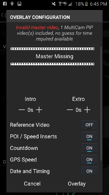

I need help with overlay configuration.
I get this message Invalid master video
Master Missing
I have no idea what I'm doing
Re: Android Grand Prix Overlay Issue
Please add your system configuration. Usually this means the video cannot be found. Please verify you can see it in Video List first.

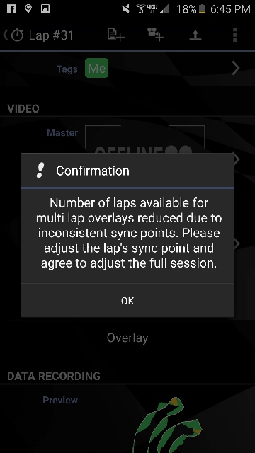

When I attempt overlay I get this Message:
!Confirmation
Number of laps availabe for
multilap overlays reduced due to
inconsistent synch points. Please
adjust the lap's syncpoint and
agree to adjust the full session
Does this help?
This simply means the laps covered by the video are not continuous - i.e. have some time missing between consecutive laps. This just keeps you from overlaying them in one multi lap overlay. They can still be overlaid individually. This is not related to the missing master video message. Btw. the limit of 2 GB is (hopefully) gone for LapTimer v19.

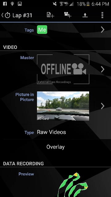

When selecting the lap, what does Lap Details show in the Video section?

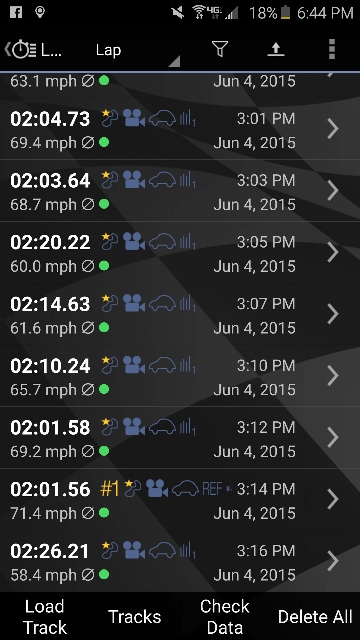

I'm sorry Harry, I do not follow. Go into video list I have 4 videos, I pick the last video, final session, list's all the laps (except the fast one I just mistakenly deleted) <<<Can I get that back? If I choose a lap it pops up a video sync setting where I adjust the start finish line? Asks me if I want to do this for this lap or entire session? I can change it but I do not get any further than that

One thing I notice is the Master Video is listed as OFFLINE and Picture in Picture is my phone video, is this correct, I only used my phone for video.
