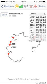

That's what I see right now:

You will always see drivers using the track set selected. So if you select another NOS config, BTG drivers will be invisible... But when selecting the track, you should see the actual number of active drivers (that should appear as dots)...
