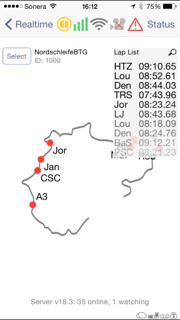

Re: Sometimes no moving Points in online View
That's what I see right now:

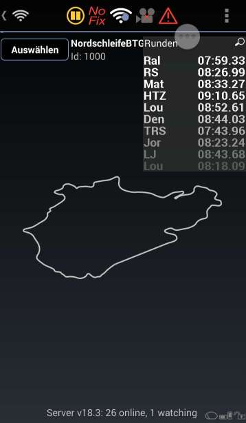

I tried to append a screenshot, but all I can create is to big for this forum. NOS BTG is selected for Lokal track and online.

Second try. Thats, what I see:
I tried with my second Android (Galaxy S5), too. But its the same. No points on every active track.
Or do I have a problem with on license on two devices (Same google account) now?
Yes, I raised the quota, it has been ridiculous small... The second phone should not be an issue.
I have organized a Droid and checked. It seems to be a bug in the current version. I will try to fix it fast and come back.
