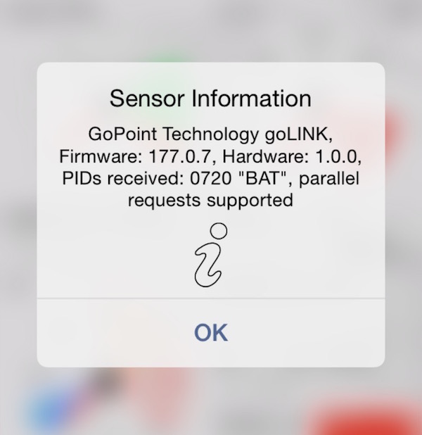

Hi!
Can someone check whether its latest version?
Cant get data from car
Re: Gopoint BT1 firmware/sowtware
From other post here on the forum it seems the 177.0.7 is not the problem (but not sure it is the latest). Please try forcing sequential request in LapTimer / Expert Settings or exclude the BAT request 0720 (exclude PIDs) - which is an expert setting too.

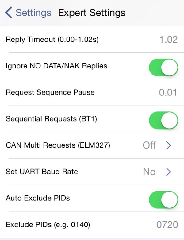

Enable both BT1 requests and Auto Exclude PIDs, or just try each separate option?
Auto Exclude will probably add more PIDs to excluded than necessary. This option automatically changes the Exclude PIDs entry below. So please turn if off.
stasmagic
Posts: 11
Joined: Sat May 18, 2013 8:14 am
Post by stasmagic »
So turn on seqrequest, off autoexclude and put manualy exclude pid 0720?
Yes
stasmagic
Posts: 11
Post by stasmagic »
Done. Now this(
