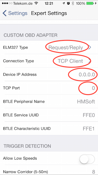

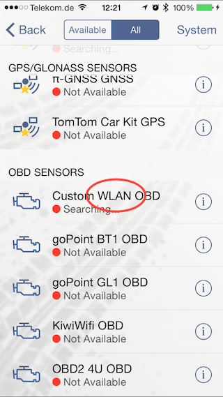

All of Harry's apps starting with v19 will come with a set of Expert Settings similar to those shown below. Our free GPS/OBD Buddy includes all of this options starting with 18.9.2. It is the best platform to develop your solution, as it does not only provide everything you need, but has complete logging enabled for debugging.
Using WiFi as connection technology: to use WiFi, your platform needs to have an IP address the app can communicate to and it needs to habe a TCP socket listening to a certain port. It is recommended to use your own combination (i.e. not those of well known solutions like OBDLink MX WiFi or the Kiwis) to not generate conflicts during testing. The snapshots below show the relevant fields. Top down, for WiFi these are "ELM327 Type" specifying the standard request / reply pattern described above, a connection type not further detailed here, the named IP address and TCP port mentioned above ("Device IP Address" and "TCP Port". The sensor list will show up like in the second snapshot.

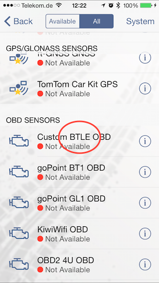

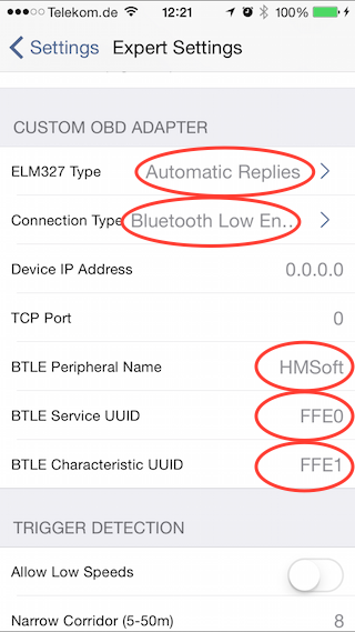

Using BT LE as communication technology: completely new starting with v19, this allows you to use e.g. an Arduino board featuring a BT LE module. Accessing the BT LE streams depend on the Arduino solution used, but will basically built stream on top of a well known BT LE characteristic. The sample below uses a programmable Freematics OBD dongle (not recommended in general from my side, but the platform I used for testing).
Image Image
When using BT LE, you need to specify the device's name, the service UUID and the characteristic UUID used for the stream. By switching the "Connection Type" to Bluetooth Low Energy, LapTimer et al will remove the WiFi custom sensor and replace it by a BTLE type (as seen in the second snapshot).

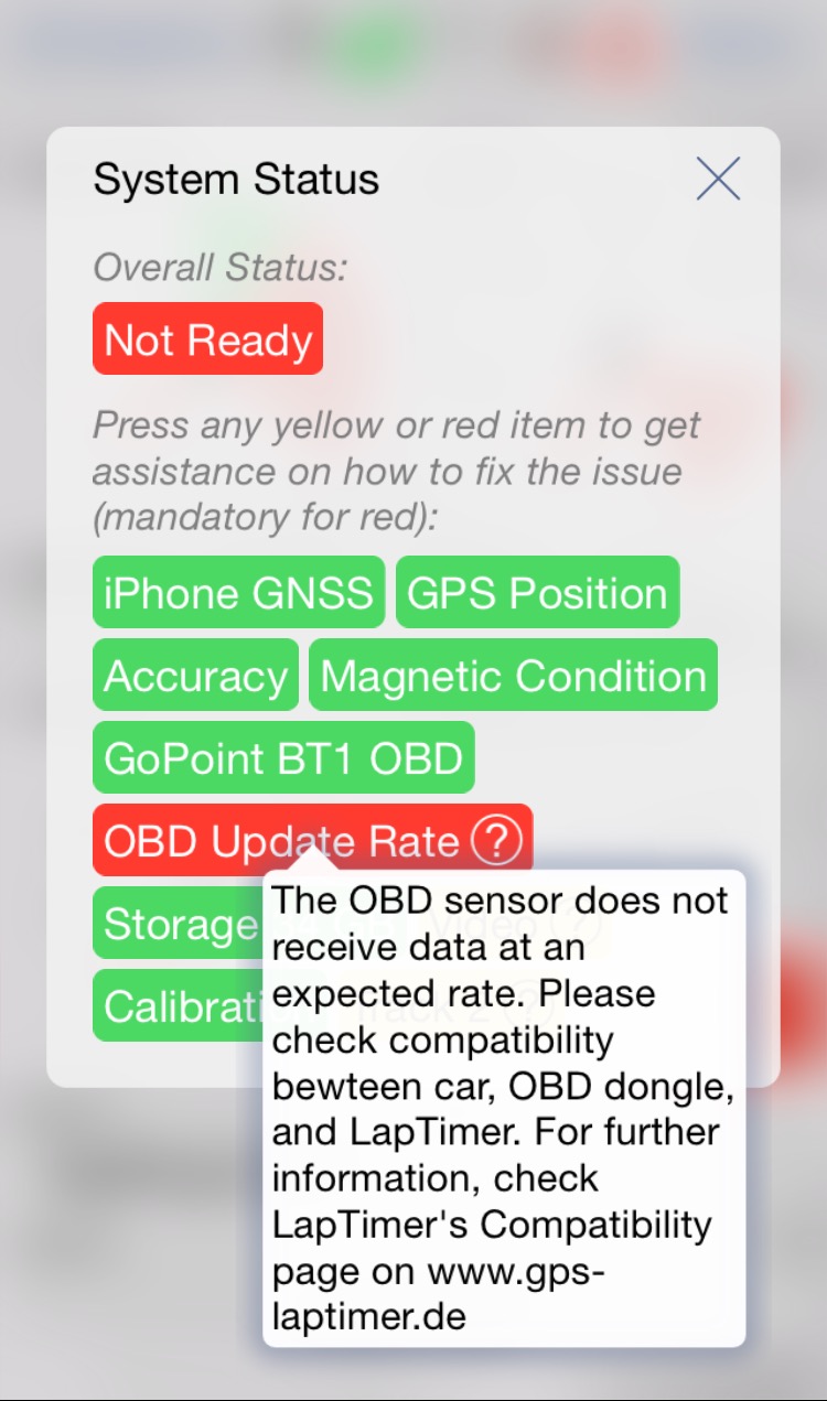

Please help on BT1 issue.
Device is connected, but no data received

Please check if you have the latest BT1 firmware installed.
Harry

Harry wrote:Please check if you have the latest BT1 firmware installed.
Harry
Its firmware 177.0.7
Gopoint sais its updates when running app on iPhone.
Any other sources of latest firmware check? Cant find on official site
