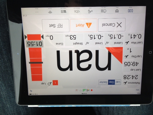

I was testing again with the road rally configuration (v18.3.3, iPhone 4s, iPad, XGPS160) and the standing go gap in timer view on the iPad was nan (not a number). When I started, nan was immediately displayed. Sorry the photo is upside down!
Also, both the iPhone and iPad became disconnected to the XGPS160. I suppose this is something I should address with Dual, correct? Have you heard of other reports of losing the connection? Any tests you might suggest I run?

nan = not a number
This means LapTimer cannot calculate the gap for some mathematical reason. Is this on your rally and are you "one track"?

Yes, I was testing on a local highway. I have used this rally track and reference lap before without any problem. My iPhone, which was configured exactly the same, started fine.

So you are driving on a completely different route compared to the reference lap?

No, track and reference lap are consistent. The track covers a stretch of local highway and the reference lap is spreadsheet generated and follows the track.
