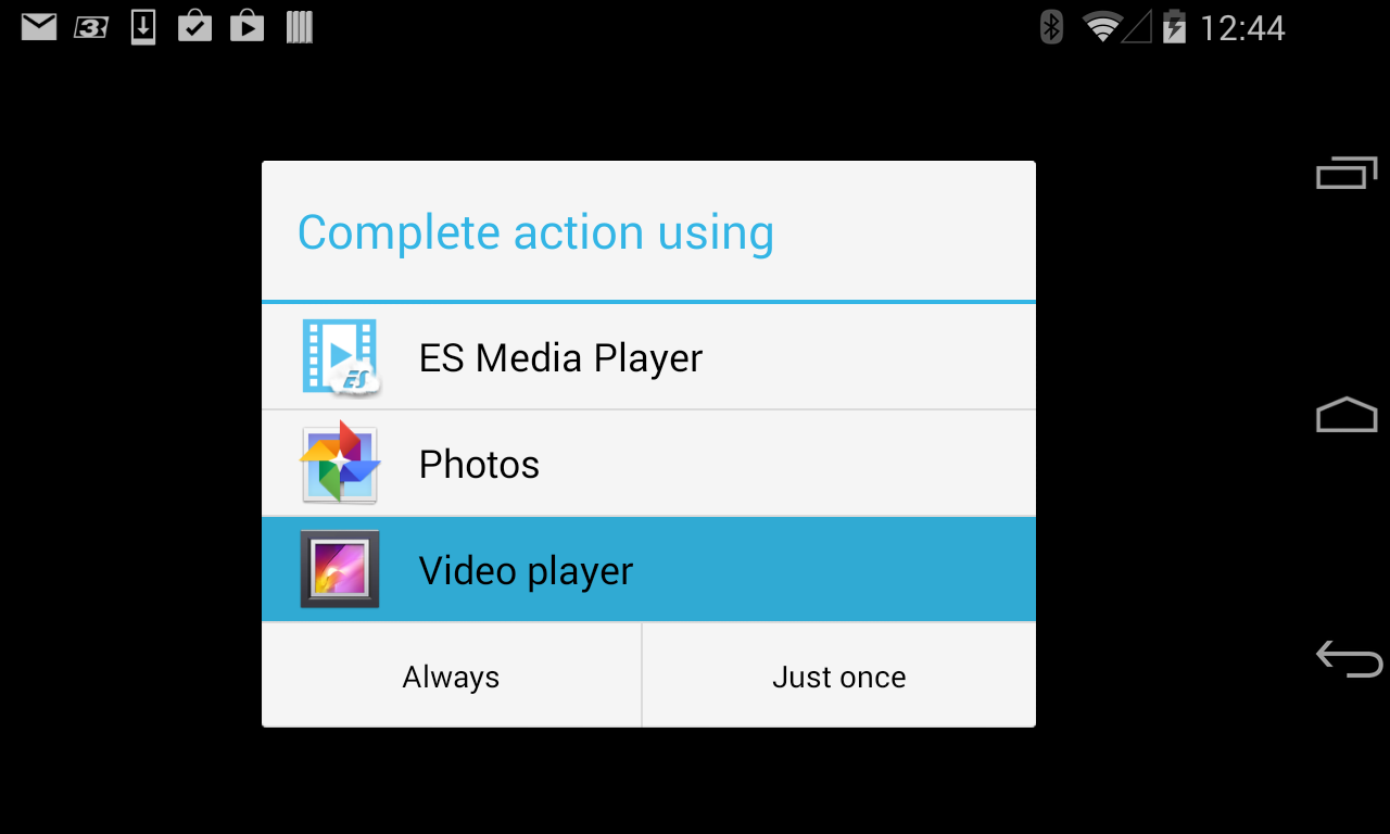

When playing a video from within LapTimer, an external video player is started. The video player selected depends on your system and existing file associations. When playing a video on my test device, I get a question like this:
My theory on what happens for your configuration is as follows: the reason I get the above query is I have never chosen a particular video player for the .mp4 extension but press "Just Once" every time. In case you do not get this screen, you have either associated an app with .mp4 or your smartphone has only one app available - which is auto-selected. In both cases, Android starts this app and passed the .mp4 file to it. The app in turn is not able to open the video - and you are back on the launcher screen.
