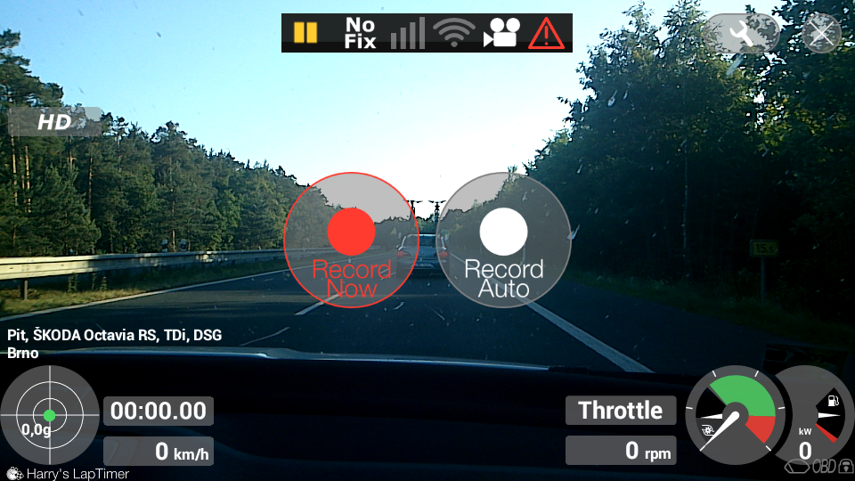

So, i have been in car. OBD ELM327 works ;) , but it seems a little bit slower then before. Refresh rate shows 3Hz (i dont know how much is before), but RPM not rise and fall "smoothly", but jumping erratically. In previous versions this is much better. As allways I compare it with Torque :), and in that app rpm rise and fall allmost smoothly.
And i have another question :)
Bar which showing throttle it´s a little bit funny. If I dont push throttle pedal it´s show full, if I push it on 2000rpm it´s show zero or minimum... It's possible that it's because I have DSG?

Update rates have not changed, at least not from the coding side. Whether the rpm reacts faster or slower depends on the amount of other data collected. As LapTimer is for recording, not for showing a selected set of data, it needs to capture data independent of the display status. Throttle needs to be calibrated as max an min values depend on your car. So until you fully throttle your car at least once, data shown may look strange. Not a problem on track, but when testing on public roads.
