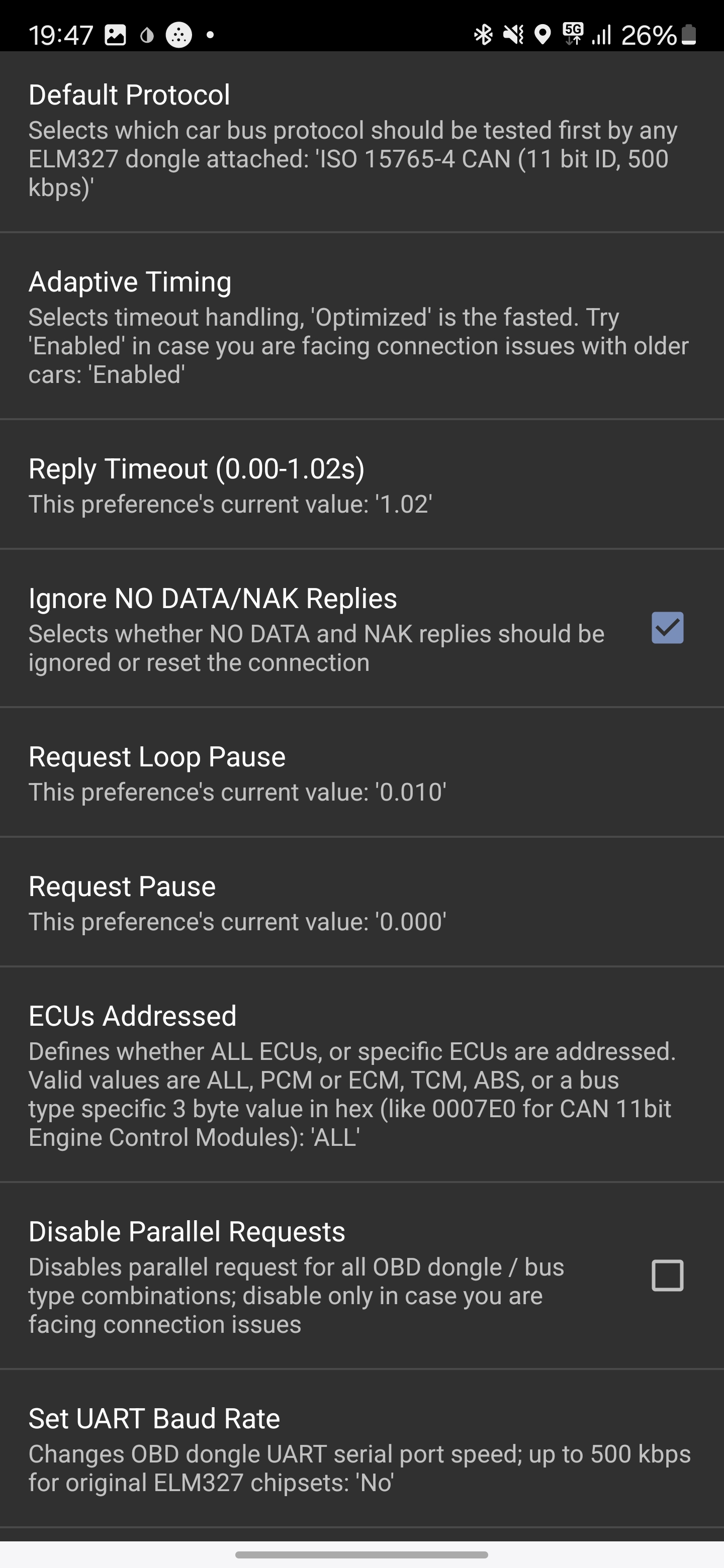

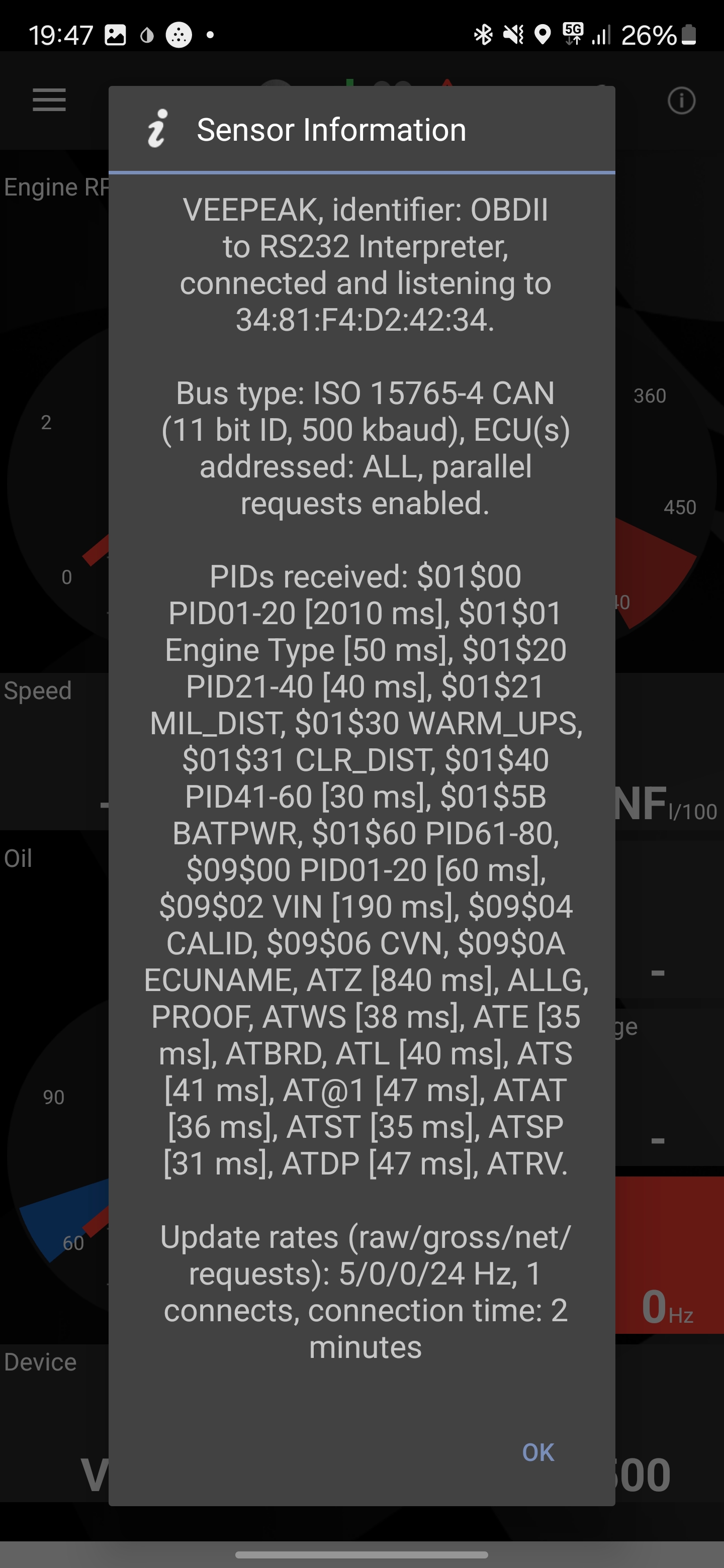

I ask everyone with a BEV (no PHEVs please) to share data over OBD available. I'm not sure this will follow a standard, but we will see. To share data, connect an OBD adapter to your EV and drive a bit. Change to Administration ‣ Sensor List and select the OBD sensor. Create a screen shot of the Info shown for this sensor. In case the display is longer than a screen, create enough to cover everything. Add information on your vehicle model and year too please. Using the list of PIDs supported, I can probably see if I can deal with data provided.
Re: Support for EVs (Tesla)
Hey Harry,
I'm attaching the sensor info together with my expert settings. If it's helpful, a couple of people gathered PIDs for RaceChrono for Hyundai IONIQ 5 N, I'm linking their repos as well.
My car is '24 Hyundai IONIQ 5 N.
