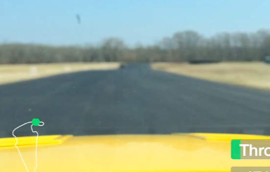

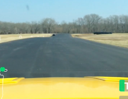

In fact, here are two screen shots from almost exactly the same point on a single video, to show one blurry and one crisp
- Blurry.png (181.37 KiB) Viewed 4186 times
- Crisp.png (159.91 KiB) Viewed 4186 times

I have an iPhone 5c and am having the exact same problem. The focus on the camera keeps hunting from near to far. I've tried the focus lock feature, but it doesn't seem to have any effect. I've tried turning off the video stabilizer. It happens even when the windshield is crystal clean. Nothing that I can think of has made any difference. It's a shame, because this problem makes the video almost unwatchable.
Any suggestions??
Any suggestions??

The lock focus feature handling seems to have been changed in iOS7 (so for all 5Cs and 5Ss by definition). Since then, these settings are considered a "hint" by iOS but are not executed necessarily. I ran several tests on this and found the lock focus *has* an effect because it reduced auto focus activities noticeable. But it does not completely mute them like they did in iOS6.
Despite setting the lock focus in LapTimer, the (partial) work around for the issue is to reduce any trigger for an iOS-initiated auto focus as much as possible, device vibration in particular. This means please use the recommended RAM mount with the arm oriented from top to bottom: to make it clear, add the suction cup to the top center of the windscreen, let the arm point down, and attach the iPhone "below" the suction cup. When using the arm in any horizontal orientation, you will get strong vertical vibrations, letting iOS go wild with stabilization and focus.
That's the best can do currently. Apple has announced "direct cam control" for iOS8, but I have not seen documentation on this feature yet. I will watch that and add whatever is possible.
