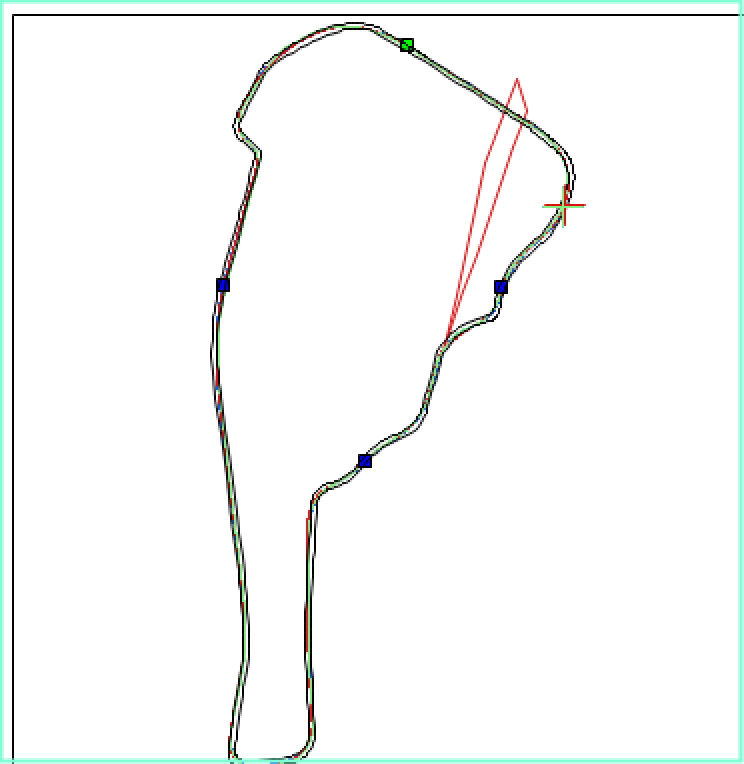

I have a lap that has some bad data points way off line. I have tried unsuccessfully to delete or fix them. Is there a better way? The goal is to use Circuit Tools for lap analysis and clean up video/data overlays.
Data File is here: https://dl.dropboxusercontent.com/u/571 ... 936.hlptrl
One of the laps showing bad Data Points
RA Lap.png (35.22 KiB) Viewed 42375 times

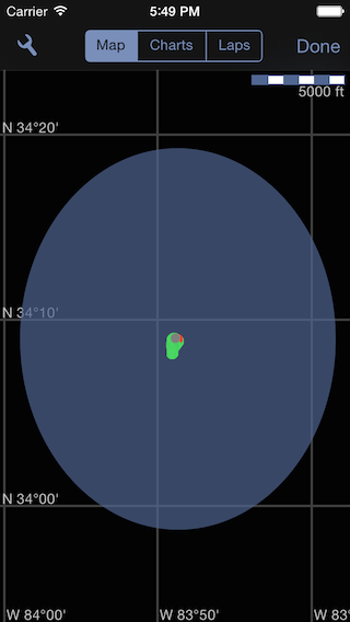

Here is a how-to:
  • Export exactly the lap showing issues to .hlptrl (the above file shows a full day laps - which makes it difficult to find the bad fixes). Send the export to yourself to edit it.
  • In case it arrives as a .hlptrz file it is compressed and needs to be uncompressed: rename it to .hlptrl.gz and use your favorite unpacker to uncompress it.
  • Check the lap for the problem you are looking for. Looking into your sample, it seems there are two fixes with very bad accuracy (red dots when GPS fixes are displayed in LapTimer's Data Recording area and large blue bubbles for the accuracy.
  • Open the .hlptrl file using either TextWrangler on MacOSX or Notepad++ on Windows.
  • Search for the problem (bad accuracy in our case) and remove the faulty fixes:

  • Once the faulty fixes are removed, save the file and send it to any email account you can access on your smartphone.
  • Long press the attachment in the mail app and select LapTimer to import it.
  • Once this is done, you will find an additional lap (same date / time) without the problem fixes; remove the faulty one.
iOS Simulator Screen shot 18.05.2014 17.49.33.png (61.19 KiB) Viewed 42373 times
iOS Simulator Screen shot 18.05.2014 17.49.22.png (44.85 KiB) Viewed 42373 times
