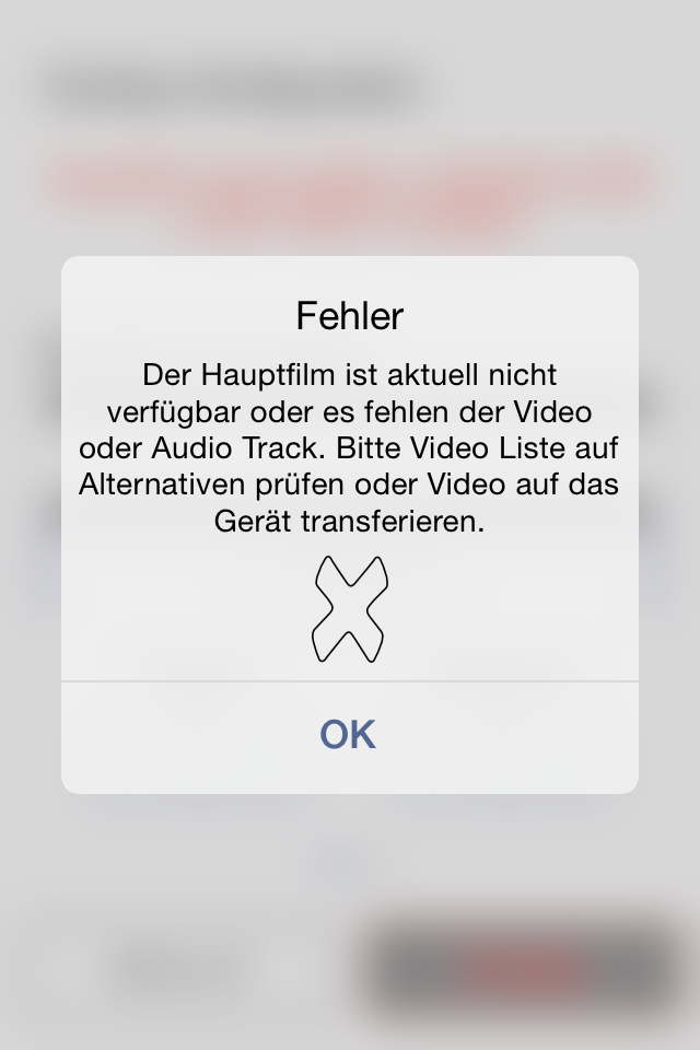

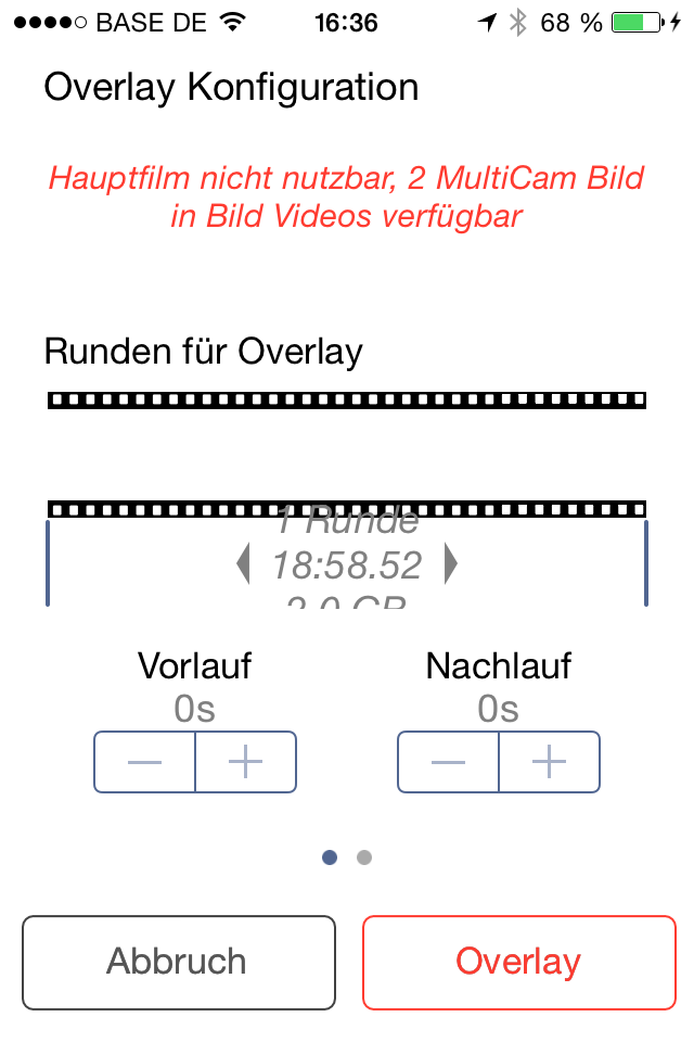

Hello!
I recorded a video with Laptimer GP on the iPhone with my Gopro as satellite. Gopro splitted the file into 2 files, which i joined with avidemux (stream copy). So I tagged the file according the documentation, transferred it to the iPhone and Laptimer recognized the Gopro file.
Then i wanted to swad the iPhone video and Gopro video - Gopro as main video file and iPhone as PiP (or maybe delete). When I try to create the overlay Laptimer brings up an error: "Hauptfilm nicht nutzbar, 2 MultiCam Bild in Bild Videos verfügbar". ("Main Video not useable, 2 MultiCam Picture in Picture videos available.") I then go forward by clicking 'Overlay' then the message is followed by "Der Haupfilm ist aktuell nicht verfügbar oder es fehlen der Video oder Audio Track. Bitte Video Liste prüfen...." ("The Mainvideo is not available or the audio or video track is missing. Please check video list....") The joined videofile is playable in the iPhone Camera Roll...
What am I doing wrong? Thanks in advance!
- IMG_3521.PNG (152.58 KiB) Viewed 3463 times
- IMG_3520.PNG (60.57 KiB) Viewed 3463 times
Re: Problem importing GoPro Video File on iOS 7
Despite it plays in the video player, this seems to be an issue with the video format. In case you have ffprob installed, please let me know what "ffprob -i <video>" reports.
P.S. Seems the layout is not great for the 3.5 inch iPhone...
Thank you Harry for your quick response. Hereby the output of ffprobe.exe on the used videofile:

May be h264 be the problem?
No, H.264 and AAC is fine for the encoder side. Can you please add the -show_format option please?
ffprobe -show_format -i <video>
It is probably a .mp4 container, the preferred format for iOS is .mov
You may try a conversion like this:
ffmpeg -i video.mp4 video.mov

Okay thank you Harry, but it looks like it already is .mov now?
