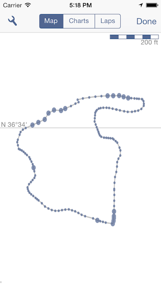

Thanks for sending your data. I believe it is about GPS accuracy.
Looking into the overall accuracy, you can see quite some areas of low accuracy:
iOS Simulator Screen shot 31.03.2014 17.18.23.png (45.7 KiB) Viewed 8784 times

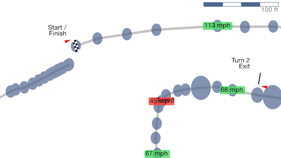

Having a deeper look into the situation on the start / finish line, it becomes obvious that besides accuracy (which is typically added to the detection corridor to work around issues like this), the positions recorded show either a drift in GPS, or a line driven on the left of the track when starting and on the right of the track when finishing. Although any of this items should typically be handled well, the combination from rain, accuracy, drift, and line has probably been too much for the missing laps.
iOS Simulator Screen shot 31.03.2014 17.24.17.png (51.61 KiB) Viewed 8784 times

Hmmm - they recently repaved VIR. I wonder if the original points were taken on one side of the near side of the track, by the kink, and I was out further to come back across the kink?
Would there be any benefit to recalculating the lap(s) and setting the accuracy to wide?

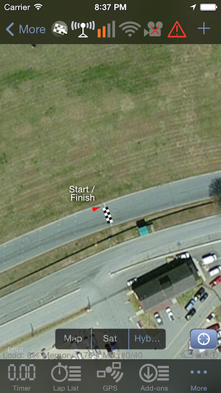

For triggers with direction, the detection corridor is always wide. The setting applies to triggers without driving direction only. Looking into the current map view, the trigger position looks fine. But please check yourself, I have never been to VIR :-)
iOS Simulator Screen shot 31.03.2014 20.37.16.png (353.05 KiB) Viewed 8777 times

Yes, that's right - that's VIR.
