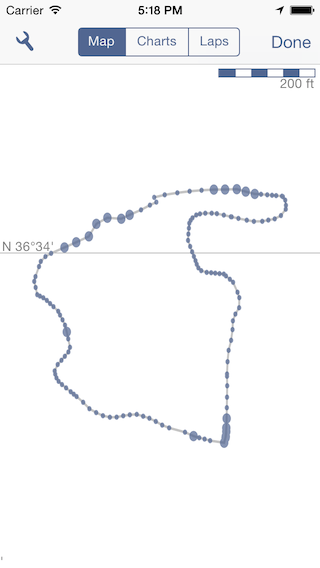

Thanks for sending your data. I believe it is about GPS accuracy.
Looking into the overall accuracy, you can see quite some areas of low accuracy:

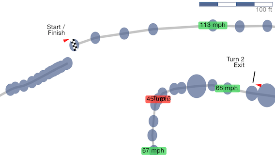

Having a deeper look into the situation on the start / finish line, it becomes obvious that besides accuracy (which is typically added to the detection corridor to work around issues like this), the positions recorded show either a drift in GPS, or a line driven on the left of the track when starting and on the right of the track when finishing. Although any of this items should typically be handled well, the combination from rain, accuracy, drift, and line has probably been too much for the missing laps.

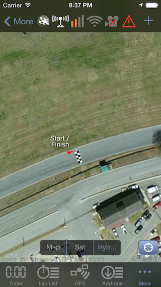

For triggers with direction, the detection corridor is always wide. The setting applies to triggers without driving direction only. Looking into the current map view, the trigger position looks fine. But please check yourself, I have never been to VIR :-)
