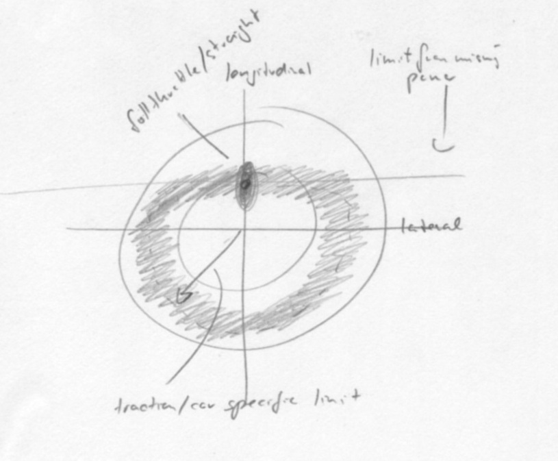

You are right it is not the best chart to analyze any particular position on track. But it allows to understand the driver's general capabilities in a second ;-) The ideal form will actually look like the sketch below. There will always be some noise in the middle, but the better the concentration is in the "shaded" zone, the better the driver will usually be.
The dark shaded area in the top centered is the area you will have at full throttle driving a straight line. For very long straights and low powered cars, it will move towards the center. For a Corvette on standard tracks this will hardly ever happen :-D Any dots except the noise from "Ferraria effects"(? I mean load change - from throttle to brake and vice versa) are not what we want.
