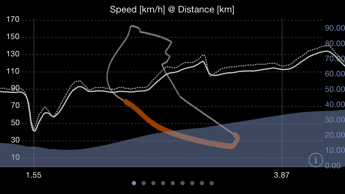

I got my BT1 yesterday, and so far, it works fairly good.
I noticed, however, that ODB speed is mostly higher than GPS speed (see screenshot) - but not as much as I figured it would be.
Readings (in kmh) be like:
Speedometer: 105
ODB: 100
GPS: 93

Re: ODB to GPS speed calibration
It is #2. Measured speed is always raised on its way to the dashboard to make sure the speed displayed is never smaller than the real speed (this is a requirement for all cars sold for public roads). When I attached an OBD the first time I thought the OBD speed is the raised speed - but this is not necessarily the case. Without insights into the design for a specific car model, you can actually say not too much about the relation between these two values, except:
  • Speed displayed by your car's speedo will always be wrong and will always be too high.
  • OBD speed *can be* the measured speed, but needn't.
  • For a drive at constant speed, GPS will always be the best and most accurate value.
The good thing is most track visitors do not need to compare absolute values mostly. Usually it is more on "is this line faster or slower". Only in case you want to compare cross cars this becomes critical. From my PoV it is best to calibrate OBD to match GPS speed using a constant drive and adjusting the Expert Setting (speed multiplier). Afterwards, it is best to use OBD as it does not miss peaks like GPS does. Finally, keep in mind OBD covers speeds up to 255 km/h (158 mph) only. LapTimer will switch to GPS for higher speeds ;-)

NRGDEAD wrote:PS: Eww, can I somehow scale down that screenshot? I figured it would be just a link.. ;-)
You need to scale it down before uploading it. Both when using the [Img] link or the attachments forum feature. On a MacBook Pro Retina display it looks great at this resolution :-D
