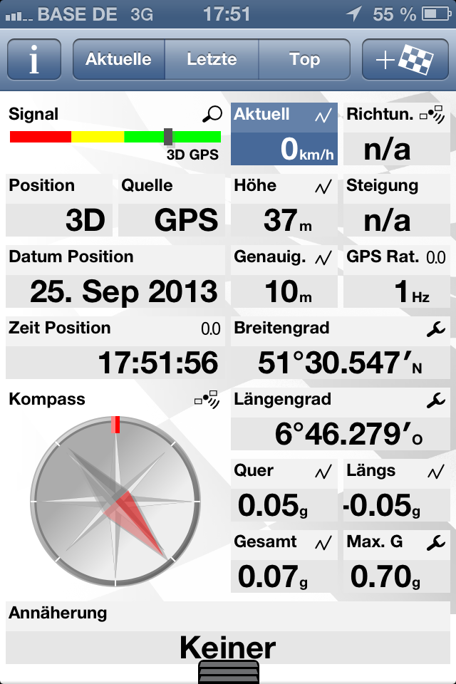

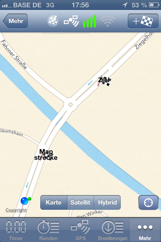

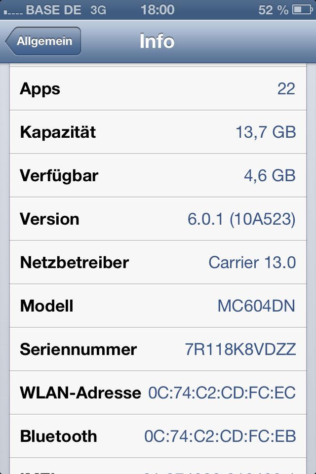

Restarted the iphone and repeat the tests on my Street and other places, it seems to crash everytime HLT wants to start Counting. When i Drive over the Start Trigger, nothing happens, after crossing the Start trigger for some meters, than the App crashes.
I'have attached you some pictures how i tryed the MAP-Trigger function and the GPS-State, also the iphone Settings.
Could it be that the Cydia Jailbreak disturbes the HLT? I think not cause the Phone works very well but HLT.
IOS Version
IOS Version
Tryed to make gps route with Map-function. Start Trigger Ziel Trigger, but no direction, didnt know what to set.
GPS Status
GPS Status

You never know what jailbreaks do, you get moved into an indeterministic space ;-) But first check another item: are you on HLT 17.4.1 already?
