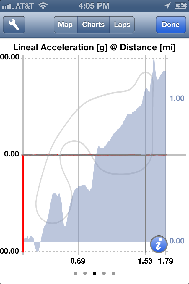

When i use the Recalculation feature to generate acceleration values based on GPS (required for a motorcycle application), there us a red vertical line that skews the chart and thus renders it useless. I've exported the data and found a "INVALIDG" value in the Lineal acceleration column. can this be fixed?

the recalcuation did not correct the blip. The file is attached. It would appear that there are two "0" distance rows at the start of the file, which would yield an error if the difference between the values is used in the divisor of the accel calculation.

Checked the calculation for the lap attached and it is indeed the two first fixes have the same time from start. Added a fix that will be part of v17.1.3. Thanks for reporting.
