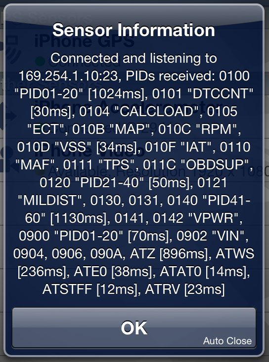

Hi
I tried putting every PID that HLT requests from OBD (as in the first post on OBD "Problem Cars" topic) on the Exclude PID list:
0100
0120
0140
0900
0920
0940
0101
0902
011C
012F
0105
015C
0106
0110
010C
0111
010B
OBD sensor works without dropping connection, but as expected no useful info is obtained.
I want RPM and Throttle position (010C and 0111). From the moment I remove one of these PID's from the list, the OBD sensor starts droping connection.
I disabled Auto-Exclude PID's. I also tried Force Sequential Requests.
Any suggestions appreciated
