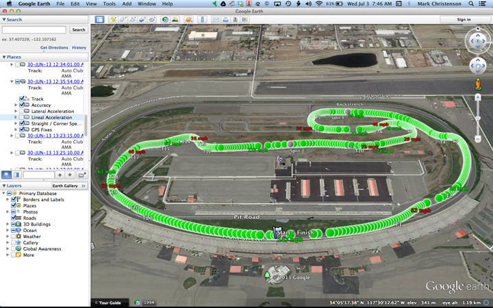

I haven't been using Google Earth to analyze. When I look at a single lap there are green dots all around except at the point of the Start/Finish and the two intermediate splits. At each of those points there is a single grey dot. Not sure what that means?

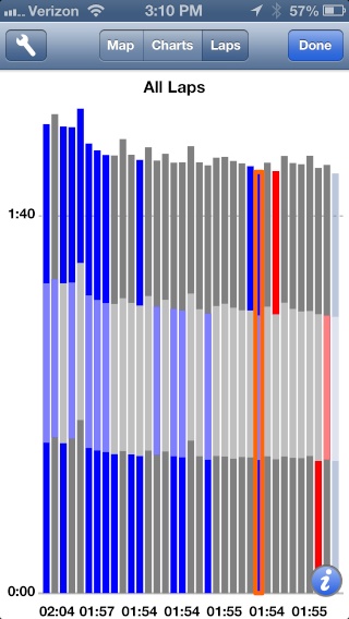

As for the info from the app, is this what you asked me to take a picture of:

Green dots mean "measured positions with good accuracy". Gray dots are the positions LapTimer calculates from the line driven and the triggers passed. These are interpolations and called "virtual positions" in LapTimer. Please note you can select / deselect details in Google Earth's left area. To check the areas around the triggers, turn off the acceleration information. It is important you can see the line driven (track), the blue bubbles displaying accuracy, and the triggers (POIs).
The bar chart is exactly what I meant. What you see is the following: red segments are the fastest sectors ever timed. So in you case the best sector 2 has been driven in your last lap (the one to the left of the transparent blue bar), the fastest sector 1 has been driven in the lap before, and the fastest sector 3 has been driven another 5 laps before. Summing this 3 fastest sectors up results in the "fastest virtual lap" - the transparent blue bar in the right. To see more details (e.g. more lap times), zoom in using two fingers. To see a legend, press the small 'i' in the bottom right.

On Google Earth I see the "Accuracy" section and it is checked, and the "Track" is checked, but I don't see anything changing on the map whether the Accuracy box is checked or unchecked (image attached).
As for the chart from HLT, I see that there are three segments. In the LapTimeDB.csv file, however, there are only times for INTERMEDIATE0 and INTERMEDIATE1 and it seems that there should be a third split time (for what it's worth, the two intermediate times add up to the total lap time).
