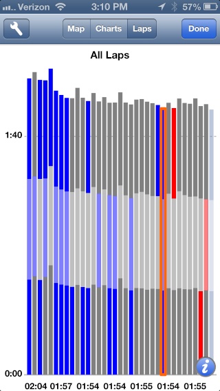

As for the info from the app, is this what you asked me to take a picture of:

The bar chart is exactly what I meant. What you see is the following: red segments are the fastest sectors ever timed. So in you case the best sector 2 has been driven in your last lap (the one to the left of the transparent blue bar), the fastest sector 1 has been driven in the lap before, and the fastest sector 3 has been driven another 5 laps before. Summing this 3 fastest sectors up results in the "fastest virtual lap" - the transparent blue bar in the right. To see more details (e.g. more lap times), zoom in using two fingers. To see a legend, press the small 'i' in the bottom right.

As for the chart from HLT, I see that there are three segments. In the LapTimeDB.csv file, however, there are only times for INTERMEDIATE0 and INTERMEDIATE1 and it seems that there should be a third split time (for what it's worth, the two intermediate times add up to the total lap time).
