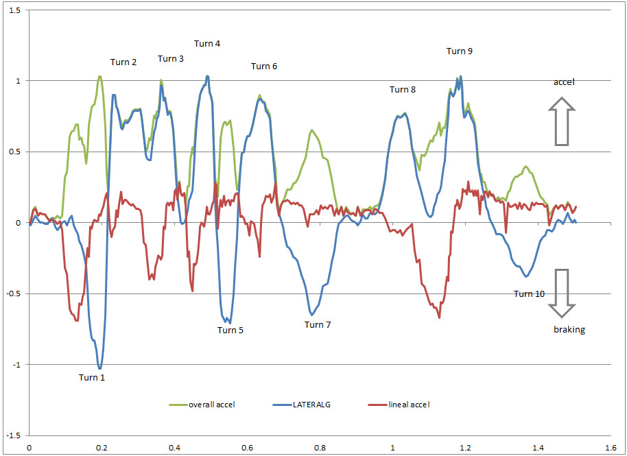

ok, i'll kick this off was some data generated by my son on a Kawasaki Ninja 250 trackbike, using an iPhone and XPGS150 running at 4hz. The GPS data was recalculated for acceleration (no iPhone accelerometer data was used).
keep in mind that this machine is fairly underpowered bike (~25 hp), so maximizing the tires' potential and maintaining momentum is the name of the game. i'm keenly interested in analyzing this data in the hopes that it might reveal areas for improvement.
so let the games begin!!!

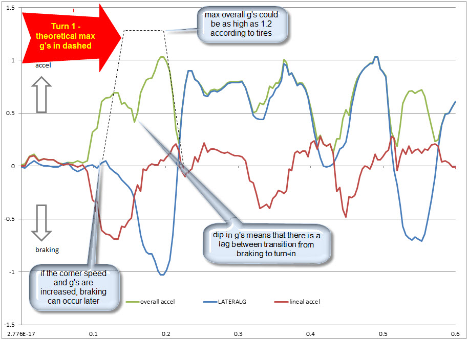

here is my swag at analyzing Turn 1 which is a good one because it it occurs at the end of long straight and is fairly high g's.
comments and discussion appreciated!
- 7-9-2013 3-02-44 PM.jpg (136.57 KiB) Viewed 6821 times

I don't think a bike is going to be able to generate the same overall acceleration as a car. And even a car won't do 1.2g on street tires on a flat corner. It will if the corner is banked, but that's because some of the lateral acceleration in the GPS frame of reference is actually vertical acceleration in the car frame. I'll have to post some of my data from some laps around Bristol Motor Speedway to demonstrate. And most cars or bikes won't generate 1 g lineal either braking or accelerating.
That being said, the transition from braking to cornering in turn 1 could have been better. Ideally you shouldn't see a dip in the overall acceleration.

for sure this is not a straightforward exercise (no pun intended) - here's my assumptions:
1. the 1.2 µ value comes from an SAE paper that used a traction trailer under braking only. You'd have to make the assumption that a motorcycle tire's lateral CoF is the same as its longitudinal. (i've been told it may even be higher); one issue we do have is that we can't seem to warm the tire up sufficiently due to small bike, small rider. We may switch to softer compound if we can find.
2. mathematically speaking, the vehicle's acceleration in g's is limited to the tire's CoF (g's <= µ)
3. braking g's are limited NOT by the tire CoF but by the tendency of the rear wheel to lift. it's virtually impossible to lock a front tire on a racing bike (while not cornering)
While the math and all the data is very interesting, it does come down to the actual rider's comfort level on the bike. If he FEELS the bike wiggle and get loose, THAT is the limit, and no amount of techno talk will convince him to push harder.
It may turn out that the benefit of the analysis of these lap traces may be just looking for "holes" where there's opportunity to brake later, turn in sooner, or exit quicker. There's got to be other spots too... like going SLOWER in one corner to go faster in another...
