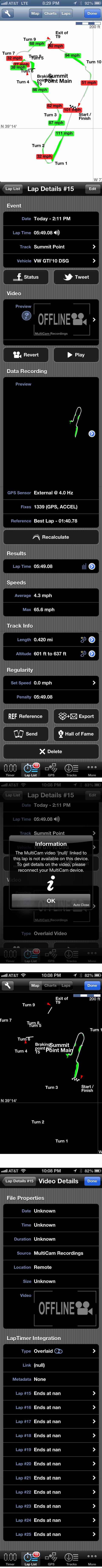

Video recording didn't appear to happen as expected. I had set the MultiCam Control Preset to Master thinking that format would make my GoPro video the main video. Is there anyway to correct the video so as to be able to place an overlay from the GoPoint and other information? Below is an image of screens.
In addition I believe my XGPS wasn't connected as I had thought which would explain the absence the lap information. The rest of the day it was tracking very well.

Yes, seems you had a drop out for GPS. Back to video: MultiCam presets have an effect on the MultiCam's resolution. I had a similar setting for the GoPro but it did not work reliantly. To use a GoPro video as the master, you need to transfer the video to the iPhone first. Please check the video documentation linked on www.gps-laptimer.de for the details. You can reorder videos linked to a lap by pressing "Edit" in Lap Details and moving videos up and down.
P.S. The MultiCam link (null) is broken too. Please remove that link and establish the connection manually if you need it (again, "Edit" and "Add Video").

Wrong path. It seems there have been issues while recording. The session video on your GoPro worked but both the links to the raw session video (null) and actual times (nan) in LapTimer were not stored correctly. Maybe there has been a problem with GPS reception or so... Links to MultiCam videos (both iOS and GoPro) are a convenience approach and hold both the raw session video's identity (multicam://) and the lap's syncPoint within the video. As you get a (null), you can delete the link altogether - it is void anyway. The correct way to relink is to add the GoPro session video from scratch: in any lap included in your big session video not showing "nan", enter Lap Details. Press "Edit" and a) remove the void links b) add the GoPro video ("Add Video"). LapTimer will ask you to select the lap's end within the video - which is exactly the step I wanted to make more convenient by introducing the GoPro MultiCam support. In your case, you need to go through the process.escottc wrote: Yes, I've transferred and tagged the videos before using VLC. However with the null value, as you already know, won't link the video once brought over to the iPhone Photo Library. I can still add the multicam://cloud/xxx-xxxxxxxx-xx, but not sure what to put there because it has the null value associated with the gopro video in Harrys Laptimer (HLT).
LapTimer records one video per session, and multiple laps per session. Overlaying extracts the lap's portion from the session video and adds lap data recordings. But that's exactly what is described in LapTimer's wonderful video documentationescottc wrote: One thing I've noticed is that there was only one video taken, but there are multiple laps listed with nan values. The laps listed with the gopro video number in the teens. I had thought that each lap would register its own video. Being the first time I've ever been on a race track (I've used it before at autocross events and its works great) it might be that I'm just seeing this for the first time since I was at a real race track.
