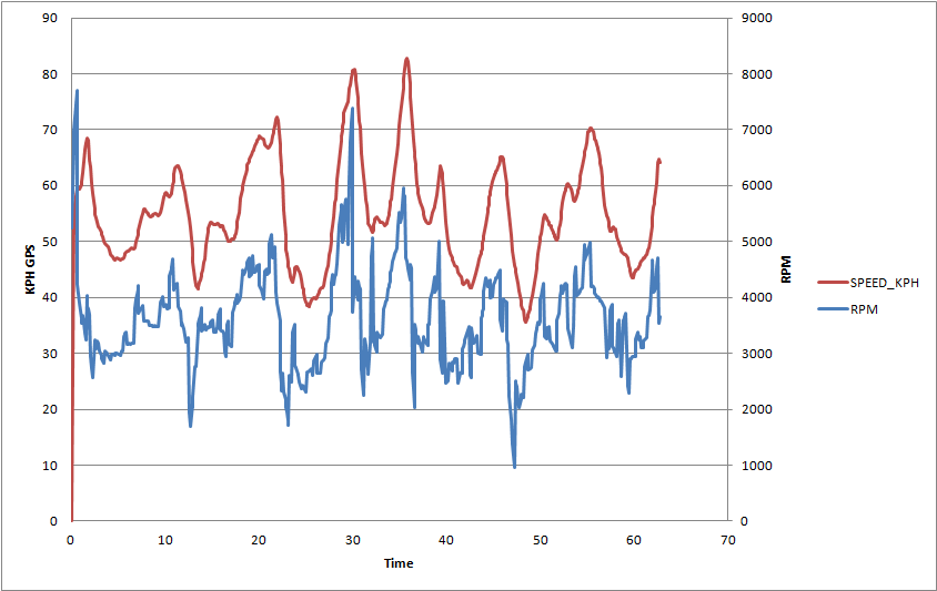

Eight seconds seems like forever. At an autocross, I'm frequently on and off the throttle several times over that length of time. 17.0.6 isn't doing a very good job with RPM either. See the attached plot comparing GPS speed and RPM. I'm always in second gear after 0.7 seconds. Needless to say, the throttle plot is much, much worse. I think it's interesting that the throttle never gets above 2.55 at any time. I can normalize the plot to the maximum reading, but it still only vaguely corresponds to reality. Is this problem made worse by the high data rate of the VBOX Sport?
July 21 2013 Run 4 GPS Speed and RPM.png (37.9 KiB) Viewed 5403 times

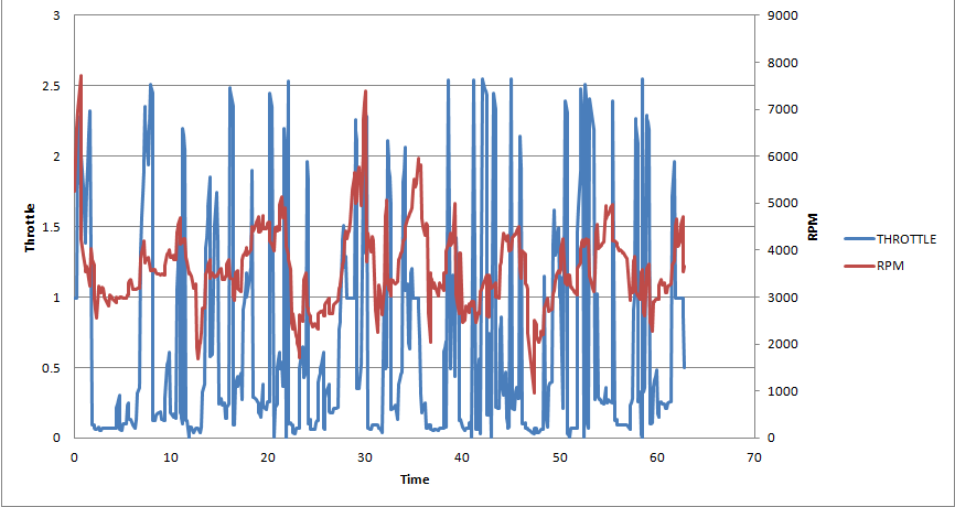

Here's the throttle and rpm graph:
July 21 2013 Run 4 Throttle and RPM.png (55.72 KiB) Viewed 5402 times
