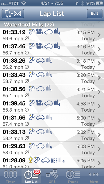

Hello, I used the latest version of Laptimer over the weekend (as of 4-22-2013) and the first 10 runs or so went OK, then I went back out for two more sessions (5-10 laps for each sesson) and the first lap or two for the first session recorded, but then an error occurred. The second session (my best), only the first lap recorded... then the error occured, then only data was recorded for the remaining laps. The data looks accurate.
I did not look close at this screen until I was done for the day and realized the video was lost, or never recorded.
What happened? And most importantly, is there any way at all to recover any video? I relied 100% on this video recording, and chose not to use my real camcorder.
Other than these crashes, it seemed to work great after adjusting for overlay sync. Used it with a BT1 on a 2010 Camaro SS.

I did have the video screen up before each session (each session was about 8-12 laps, I ran 3 sessions total). The first session worked perfectly. The last two sessions are when these errors occurred, an error popped up on the screen during the recording saying something like "There was an error". But I was driving, I tried to hit OK hoping it would continue recording... I think after this error, video recording stopped, however the video screen was still open, and eventually I noticed at least at some point that it was not recording... but the lap data was saved.

So the message has most probably been "Low memory, video recording stopped / disabled! Please free up space and return." In case this happens, LapTimer disables video recording until the Video View is closed and opened again (with enough memory available). I will add a reset in case the app is sent to background (and foregrounded again) in the next bugfix release 17.0.4. That's the problem with different using patterns, I always closed the Video View when I ran out of memory instead of pressing the Home button, clean up, and foreground LapTimer (in Video View) again...
