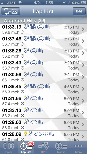

Hello, I used the latest version of Laptimer over the weekend (as of 4-22-2013) and the first 10 runs or so went OK, then I went back out for two more sessions (5-10 laps for each sesson) and the first lap or two for the first session recorded, but then an error occurred. The second session (my best), only the first lap recorded... then the error occured, then only data was recorded for the remaining laps. The data looks accurate.
I did not look close at this screen until I was done for the day and realized the video was lost, or never recorded.
What happened? And most importantly, is there any way at all to recover any video? I relied 100% on this video recording, and chose not to use my real camcorder.
Other than these crashes, it seemed to work great after adjusting for overlay sync. Used it with a BT1 on a 2010 Camaro SS.

Ok, thanks. Here is everything I could find on 4-21, the day of the problem. There were some other files from earlier dates that I also had random crashes, not sure if they apply.
I dont see the missing video's in the video list... they are not there.

I did have the video screen up before each session (each session was about 8-12 laps, I ran 3 sessions total). The first session worked perfectly. The last two sessions are when these errors occurred, an error popped up on the screen during the recording saying something like "There was an error". But I was driving, I tried to hit OK hoping it would continue recording... I think after this error, video recording stopped, however the video screen was still open, and eventually I noticed at least at some point that it was not recording... but the lap data was saved.
I'm connected by bluetooth, but Wifi may have been default ON, but I was not connected to anything. I tried to turn it on in airplane mode but then upon starting up Laptimer, it would say "Unable to download POI", so I turned airplane mode back off... plus the BlueTooth connection would probably also disconnect.
I did get low on free space after session 2, and I went and free's up ~8GB of space for the last session, but the video error occurred again. I also noticed I still had 7.5-8gb of free space after this session, another clue that there was not allot of video recorded.
I tried to grab a screen shot of the video while racing... but that didn't work out! I think I dialed 911 instead. haha
