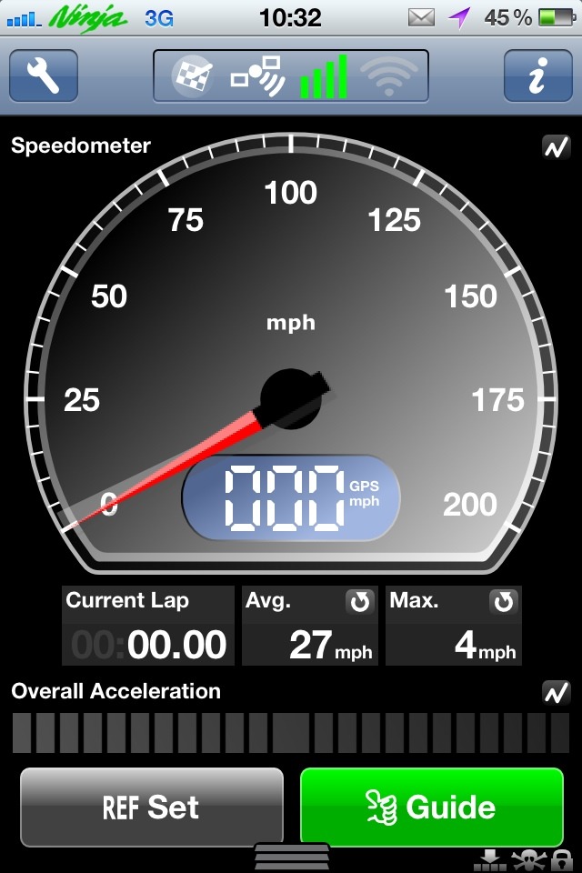

On the speedo view: once you add this feature, you will get an additional view (initially hidden behind 'More'). Please check this again.

The speedo I know where its at and I can get to the screen to view it. Does it need to pass a trigger to respond or should it work wherever you have a signal? Because I set it and riding down the road it just sat there at 0 mph.

LapTimer will not trigger below 5km/h, but you should be above this level. Both the GPS and the Speedo view show speeds as they are measured - independent of timing or not. Even when walking around, you should see the speed. The pause button means GPS quality is too bad to let LapTimer start. This should not happen. Can you please add information which iPhone generation you use?
