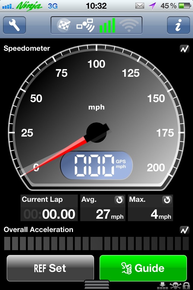

Well its not multiple POIs in the same area, all set to stop/go. For instance one was on my street in front of the house. Another was a twisty road in town and so on. I would set them and pass them around 10-20 mph and no response.
The speedo I know where its at and I can get to the screen to view it. Does it need to pass a trigger to respond or should it work wherever you have a signal? Because I set it and riding down the road it just sat there at 0 mph.
Also occasionally it has a little yellow pause icon at the top is that a bad signal or what?

Re: New guy,can't seem to get it working
LapTimer will not trigger below 5km/h, but you should be above this level. Both the GPS and the Speedo view show speeds as they are measured - independent of timing or not. Even when walking around, you should see the speed. The pause button means GPS quality is too bad to let LapTimer start. This should not happen. Can you please add information which iPhone generation you use?
