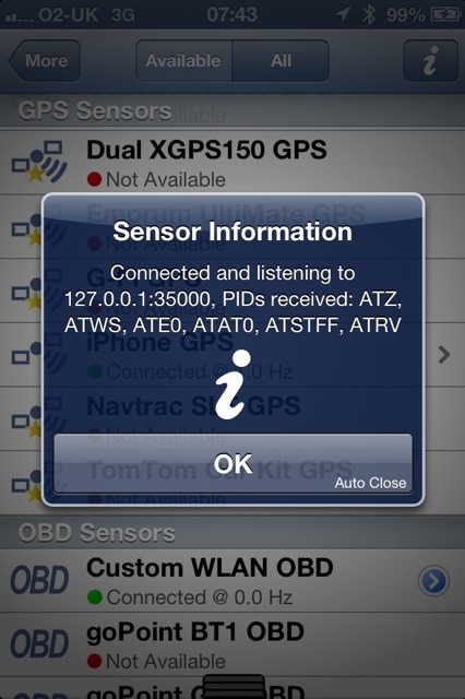

Post by rscliofan »
As you can see its shown at the bottom

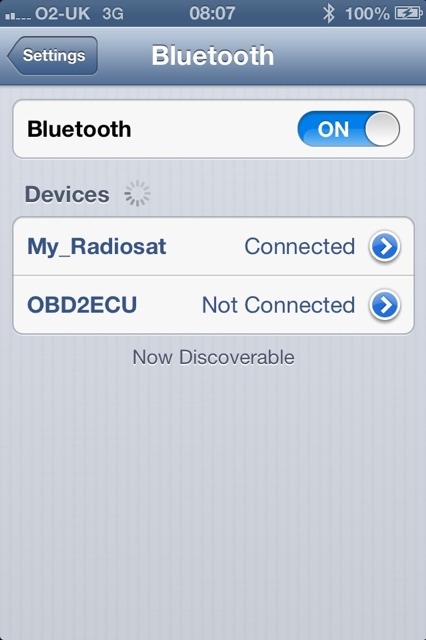

But I also see apple is also seeing it which it's never done?
Perhaps it's interfering with it?

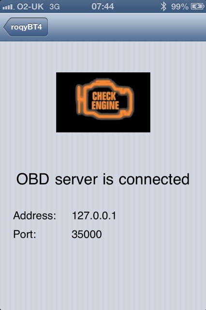

Re: roqyBT4 and Bluetooth OBDs!
I cannot comment on the Apple BT / roqyBT relation (check with the roqyBT people). The first screenshot means the OBD is detected but the request / reply dialog is not started successfully (so actually not communication).

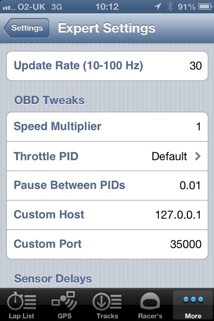

Post by rscliofan »
did you set the obd pass key to the correct setting in RogyBT4 configuration? (1234 usually). Also set automatic paring on data request to ON and in laptimer expert settings? More tab ->settings->expert settings-> in obd tweaks custom host needs setting to 127.0.0.1 and custom host 35000
