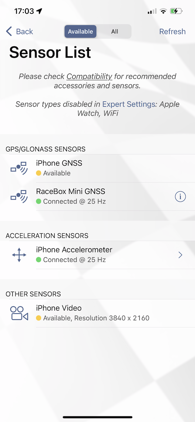

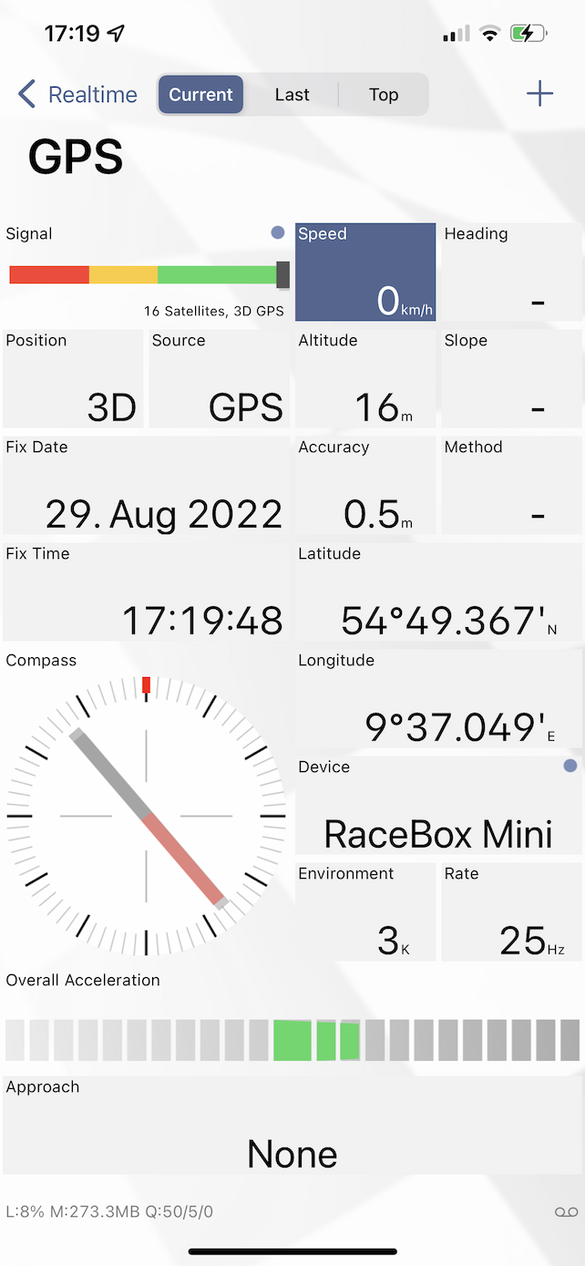

But let us understand the problem by analyzing things one by one. Please take the iPhone and the Mini with you and walk somewhere outside where no other BT devices are around. Start LapTimer and goto Administration ‣ Sensor List. After a short time, Racebox Mini should be displayed, and a few seconds (but up to 2 minutes) later, the actual update rate received is shown. It is displayed right under the Racebox Mini entry. Two views to check against:
Please let me know what you see.

Still only at 10 Hz
Blue light was on on the Race Box Mini
Sorry about the video but can’t seem to upload images.
Re: RaceBox Mini
Posted: Mon Aug 29, 2022 6:09 pm
You forgot to mention the 10Hz are in VBO. That's the working standard, at least the last CT version I tested had problems with 25 Hz. So LapTimer stores data at 25 Hz (see Lap List / a lap / Data Recordings / Fixes) but interpolates that to 10 Hz when exporting data to VBO. Exports to HLPTRL, GPX, NMEA are all the same as the LapTimer storage rate, VBO is not.

It appears that the accelerometer remains with the iPhone even though the RaceBox Mini is connected with a blue light showing.

Is it correct that the accelerometer is still in the hands of the iPhone and not the RaceBox Mini even when the RaceBox Mini is connected?

Yes, see my earlier reply here on this thread.
