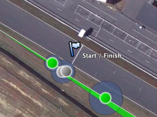

Had a look into your export (see below). The trigger seems to be placed perfectly. The distance between the measured position and the trigger is 15m according to Google Earth. Looking into the GPS plot (internal sensor), it is pretty much to the outside and shows low accuracy (blue bubble). This actually helps LapTimer to detect the trigger as it widens defined corridor (Narrow, Normal, Wide) by the current accuracy in addition. This is to allow detection with bad GPS conditions without getting too many false alarms for 'good' situation. It would be interesting to see a XGPS150 recorded lap :-) LapTimer 15.0.5 has been changed to assume a minimum accuracy of 15m (so in case the XGPS says 2m, that is ignored and 15m are used instead). Maybe that is not enough, or there is another issue...
Anyone with a XGPS recording for NJMP?
