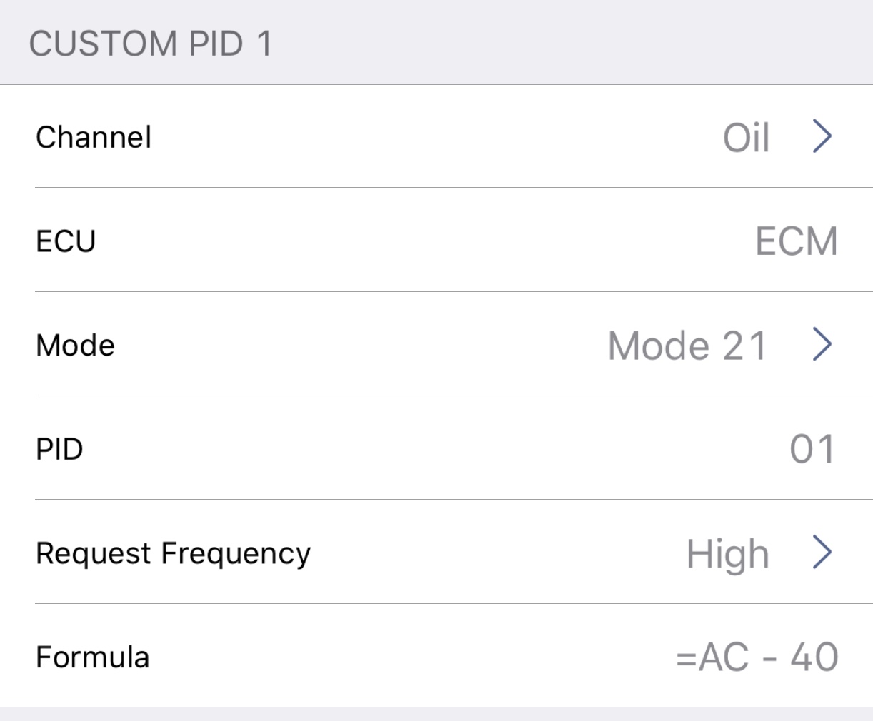

In GPS-Buddy, 23.0.03, I'm now seeing a single Oil Temp instance which reliably swaps between the stack of gauges and the dial - thanks! - but where-ever I put it, there is no data. The car is a 2013 BRZ, and I've defined a custom PID for the oil temperature (as in this post: viewtopic.php?f=20&t=1364&start=30) but the displayed value remains blank. What am I missing?
Please start with posting the OBD adapter's Sensor Information (Administration ‣ Sensors ‣ your sensor while connected).
jrobert
Joined: Thu Jun 20, 2019 3:51 pm
Post by jrobert »
Apparently something needed to be reset. I went back to make the screenshot - starting the car and opening the HGB app - and found that the oil pressure now displays properly. Thanks, Harry!
Good to hear. Some of the Expert Settings need a restart or at least a sensor reload (Administration ‣ Sensors ‣ Refresh) to get effective.

nogzie wrote: Sun Nov 25, 2018 12:19 am When I go to Sensor List > Kiwi for Sensor Information, it does show in one of the items - 0x210 0x01 EOT
This seems to be a good sign, as I've played around with the Mode and PID, and other settings I don't get this in the Sensor Information.
However - I'm still not getting any data for Oil Temp in the app.
Any tips on the PID settings, or other Expert settings?

This works.
Working 2013 FRS Oil Temp PID
